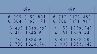

I cannot figure out how to make a parametric driven table that has limits. I understand how to use the repeat region function, but am unsure how to create a driven table that looks like the picture attached.

Those look like limit dimensions. Both values are part of one dimension feature.
Any dimension you put into the table should be able to have its properties set to "Limit" but before you change this parameter, set the plus and minus separately or you won't be able to change it.
Mar 25, 2013 7:24 PM UTC
They are limit dimensions, in the part they are set to a properties name of "A", in the family table it just shows the nominal, subsequently in the drawing table doing a repeat region on "a" only shows the nominal.
I found a slight side around to setting up the dimension as a +/- value allows me to family table a tp(#) and tm(#) value. Then chart and drive this. It gets the job done, but i would prefer it to be a driven limit toleranced value.

To show limit dimension in a drawing table do the following:
  1. 1. Create two parameters (upper & lower limits)
  2. 2. Write relations to solve for the parameters (upper equal nominal plus tp / lower equal nominal minus tm)
  3. 3. Family table add nominal, tp, tm, upper_limit, and lower_limit
  4. 4. Enter values in family table for nominal, tp, and tm
  5. 5. Verify family table (upper_limit and lower_limit will now be populated)
  6. 6. On drawing; create a simple repeat region table. The first repeat region should be the entire row below the column headers. The first column in the row should be the drawing option and all subsequent columns in the initial repeat region should have a new repeat region
  7. 7. Apply the appropriate filters to the repeat regions
  8. 8. On the drawing table use 3 columns.
    1. a. The first column will contain &fam.inst.param.value; the filter for this column is &fam.inst.param.name==UPPER_LIMIT
    2. b. The second column will contain “-“
    3. c. The third column will contain &fam.inst.param.value; the filter for this column is &fam.inst.param.name==LOWER_LIMIT
  9. 9. Merge the column header for the 3 cells associated with the required set of limit dimensions
  10. 10. Select the table; then select line display for the line in the repeat region between columns a-b and b-c (see step 8 above)

For dual dimensioning
Goto the table tab, repeat region, relations, click the tab that you want dual dimensions (if you want the table completely dual dimensioned you will need to do this for all of your pereat regions, but ctrl-c, ctrl-v is a life saver). A relations window will pop up add
IF fam_inst_raram_value<>0
CONVERT=fam_inst_param_value *25.4
ENDIF
Hit OK, and yes they are underscores, not periods.
Right click on the repeat region you just added the relation to, the value should already be;
Add this text
[&rpt.rel.convert[.2]]
So the line reads
&fam.inst.param.value [&rpt.rel.convert[.2]]
The [.2] controls the amount of decimal places, take it in or out to the required amount of precision.
