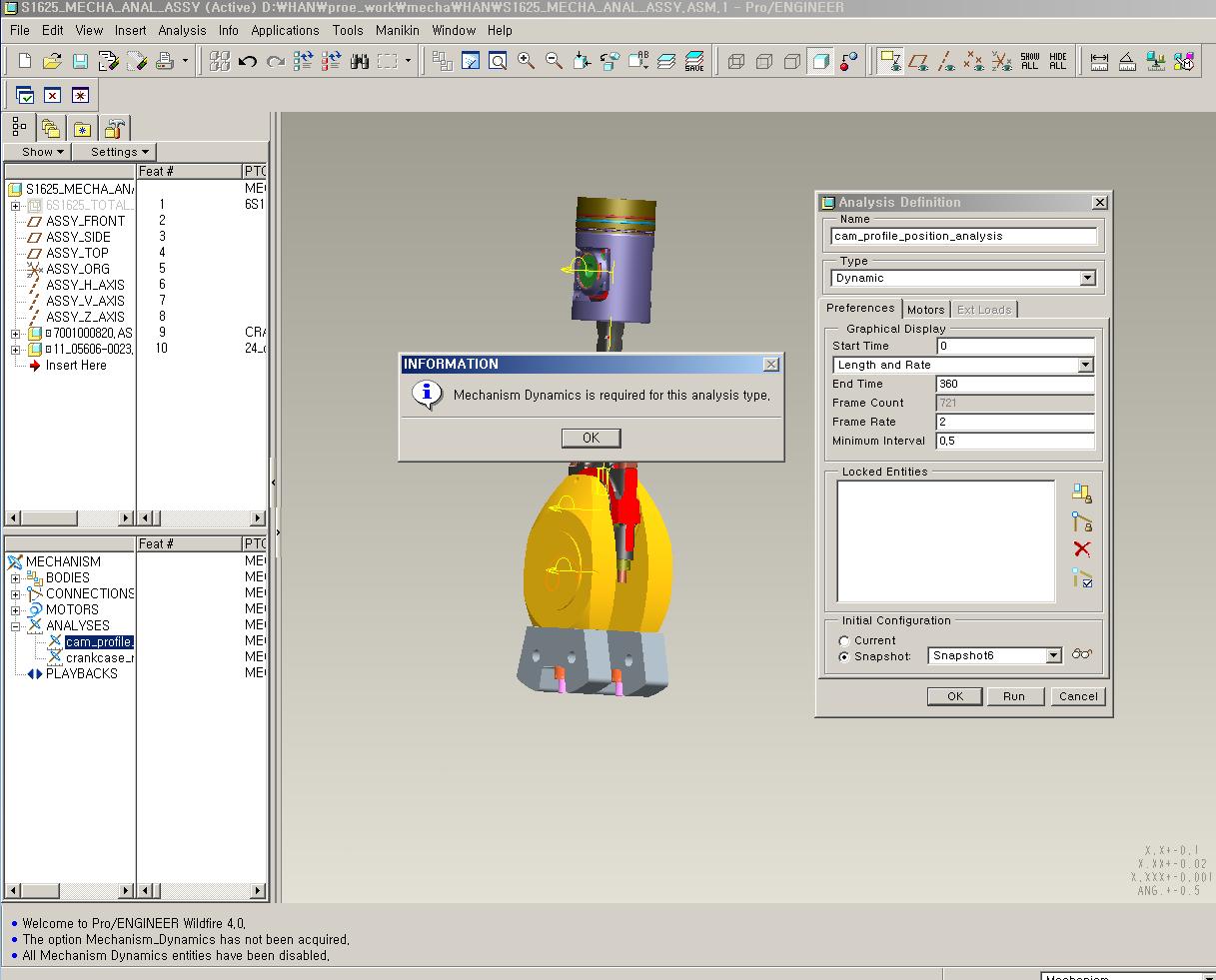

I have been practicing Mechanism.
But I ran into difficulties that is dynamic analysis can't used.
I want dynamic analysis for crankshaft.
June 28, 2012
you license does not contain MDO (Mechanism Dynamics Option - code number 191). MDO is not included in PROE_Foundation license (it contains only Mechanism Design license - code number 127).
