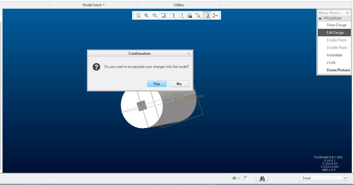

In my creo 3.0 the programming function is not working.
FYR below attached file....

December 12, 2016
click Yes button to finish action.
If you have problems, you can upload your file using procedure mentioned in How to Attach a File to a Discussion Reply
MH

December 13, 2016
I hope that you can save your part and therefore you do have write access into current working directory.
Please add the following option at the end of config.pro file. Also check whether C:\Windows\notepad.exe file exists.
pro_editor_command   C:\Windows\notepad.exe
Note: You can verify whether your config.pro file contain another occurence of pro_editor_command option.
MH
