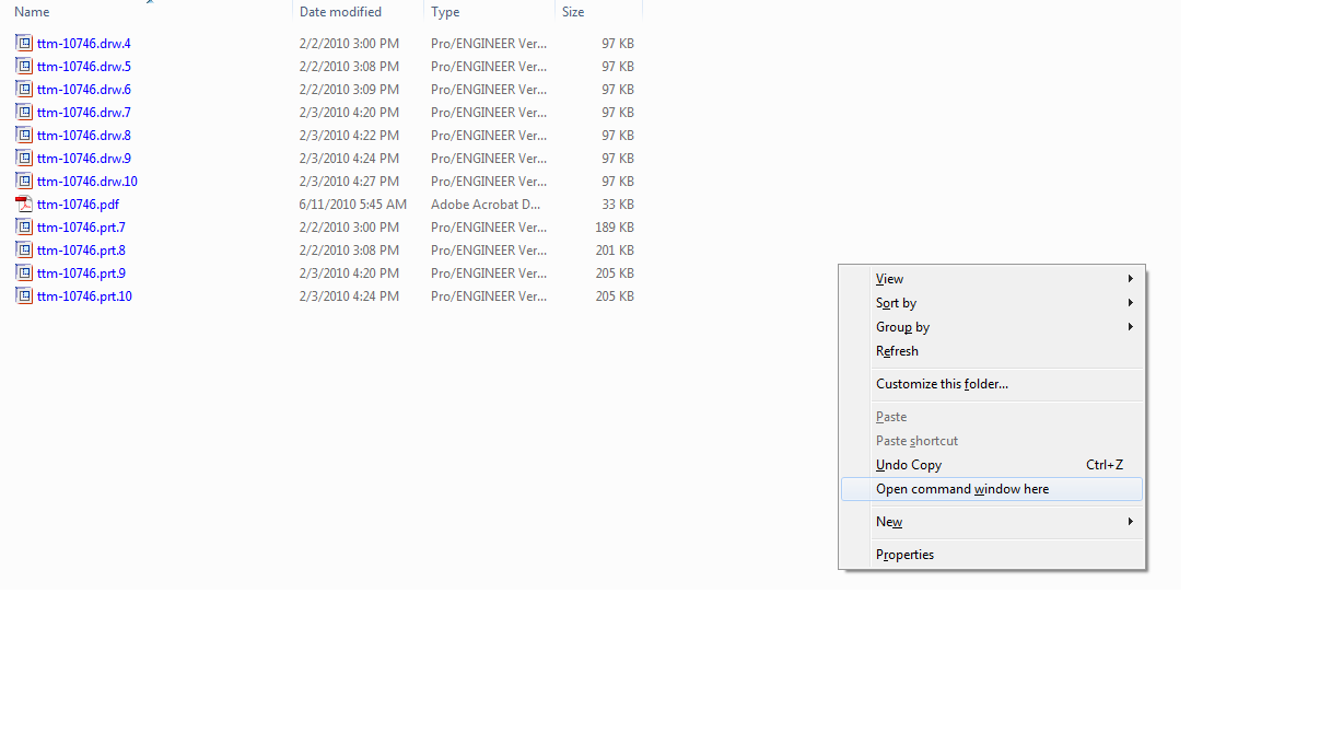

Hi All, I'm suprised nobody has posted this question before. I've since found out that within Windows 7, Tools > Folder Options does no longer exist. This would make adding the Pro Purge function alot harder to add, I know that you can add the Pro Purge option through the Registry. But this is the long handed way and wondered If anybody has found a quick way? Regards Paul

I don't use purge a lot, but when I do I just copy purge.bat to the directory I want it in and run it. This works the same in Windows 7 as it does in Windows XP and Vista. But, I might be missing something about what the Windows Folder Options has to do with purge.

I was shown to do as follows.
Click "Window" then "Open system window", Then you see in the pop-up window the file you are working in.
Type "purge" and enter. They told me too to do this with only the head-asm open.
With me this works fine.

I too really missed the RMB option when browsing the hard drive.
The "Long Hand" regedit isn't too bad and once done, you can forget it! (Which is why added the regedit instructions to the bat file itself)
Here is the content of my CleanPurge.bat:

You can still edit the "Folder" section in the Registry, but some networked folders may not work do to permissions issues.
Other than that you can shift+right click in any folder and click on "Open Command Window Here" then type "purge" this works evey time for me.
September 16, 2010
It is still possible to RMB Pro Purge within Windows 7, The way I acheived this was to export the registry values from an old XP machine and then reimport them into the Windows 7 machine.
Please see attached the Registry values that you just need to import and the RMB button is then active.
Regards
Paul
