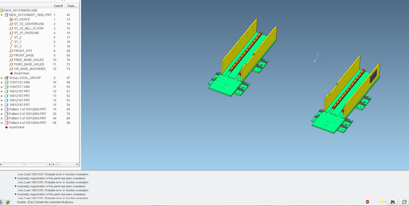

I am building an assembly in Creo 2.0 and got an error shown below. This is causing a "yellow light" regeneration as well. Any ideas?

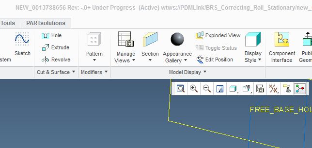

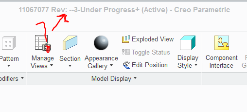

Floyd, are you running the version manager extension?
July 22, 2014
Antonius,
See below. Not sure if I am or not.
July 22, 2014
I guess this could be a PDM link thing. I have never been warned of a -POSSIBLE- function error. It either IS or it ISN'T! As a matter of fact, I've never been warned of ANY function error.

Possibly this is due to relations in part 10812197. Check and verify the relations.

This message is given when the EXTRACT function is used in Relations when the parameter length is greater as the parameter name to be extracted.
2-Explorer
July 28, 2014
Please confirm - is this error generated when trying to Extract characters beyond what the target string contains?
Extract("12345",5,2) creates an error message because it can't extract the character beyond the fifth one?
July 28, 2014
I have not tested this but that is the way I am interpretting several previous case resolutions. They seem to say that if you try to extract a certain amount of characters from a string that has a total number of characters less than that number, you will see this message.
This is copied from a previous case:
"IF EXTRACT(DESCRIPTION,70,1))==""
In the above line, without checking if the String parameter contains 70 characters or not, you have used 70 in EXTRACT function.
If the string_length of the parameter DESCRIPTION is not greater than 70, Creo Parametric stops relations execution with error message "warning: Probable error in function evaluation".
