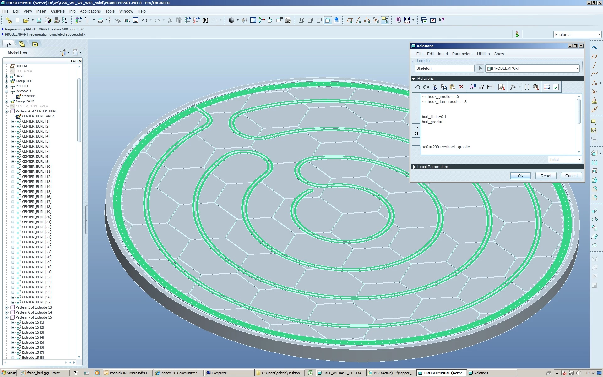

The picture 1-model_OK_hexsize-40.jpg gives an idea. The only problem is: the hexsize in it is 40 mm; I want it to be 3 mm. This means a lot more pattern instances. ProE seems to have a promblem with that.

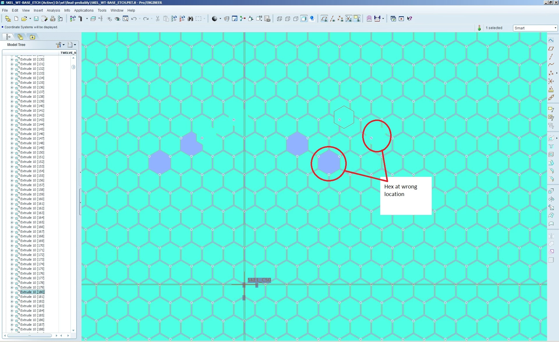

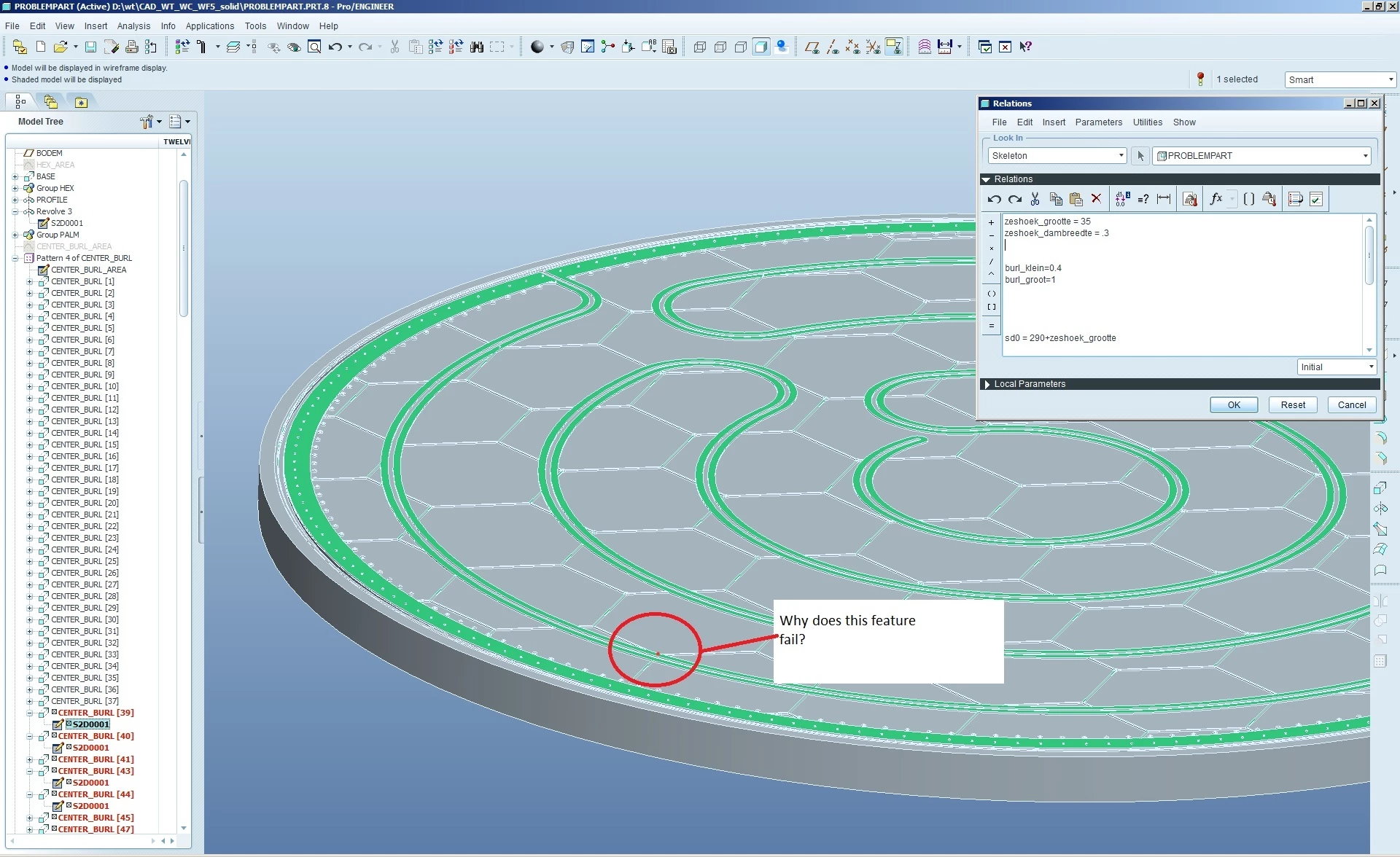

- all of a sudden, some features start to fail. Quilts won't merge anymore, cuts won't regenerate (2-failed_burl_hexsize-35.jpg).

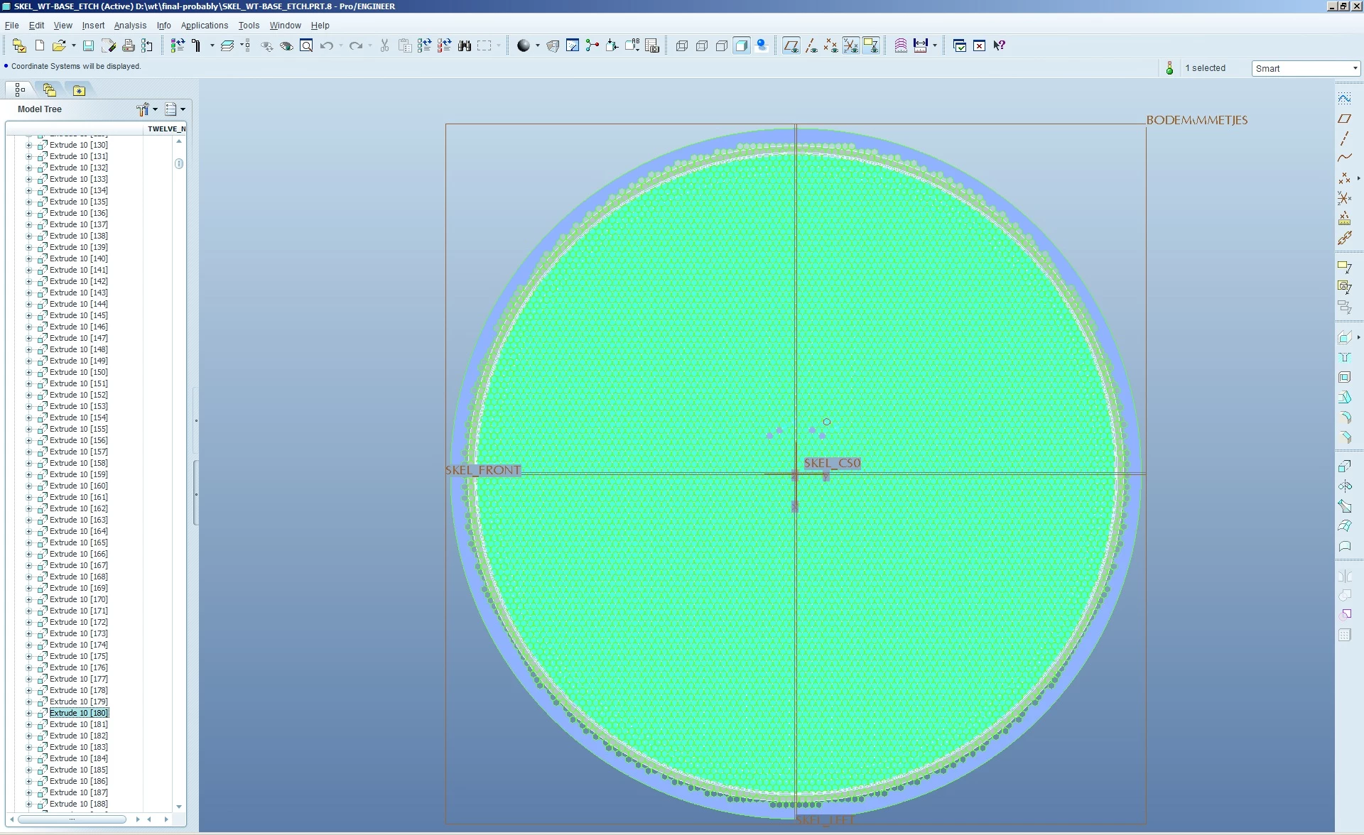

- some instances of a pattern show up at completely the wrong location (3-hex_pattern_problem1_hexsize-3.jpg).
- the amount of time it takes to regenerate increases to "rediculous" imho. Two days, just to make the hex cuts in a 2d plane!

Part of the problem I see is the order of the features. Based on what I understand you are trying to do the BURL and related featres should come before the PALM features. As you change the hexagon size there are BURL locations that end up in the PALM area and end up being inside solid geometry which may be causing the failures. Drag the PALM feature so it is the last feature before the publish geometry and see what you get. You may also want to try regenerating the patterns one at a time. There were some other things in the references for the features that I would change also. The last suggestion would be if you are trying to create a skeleton I wouldn't add all this detail.
