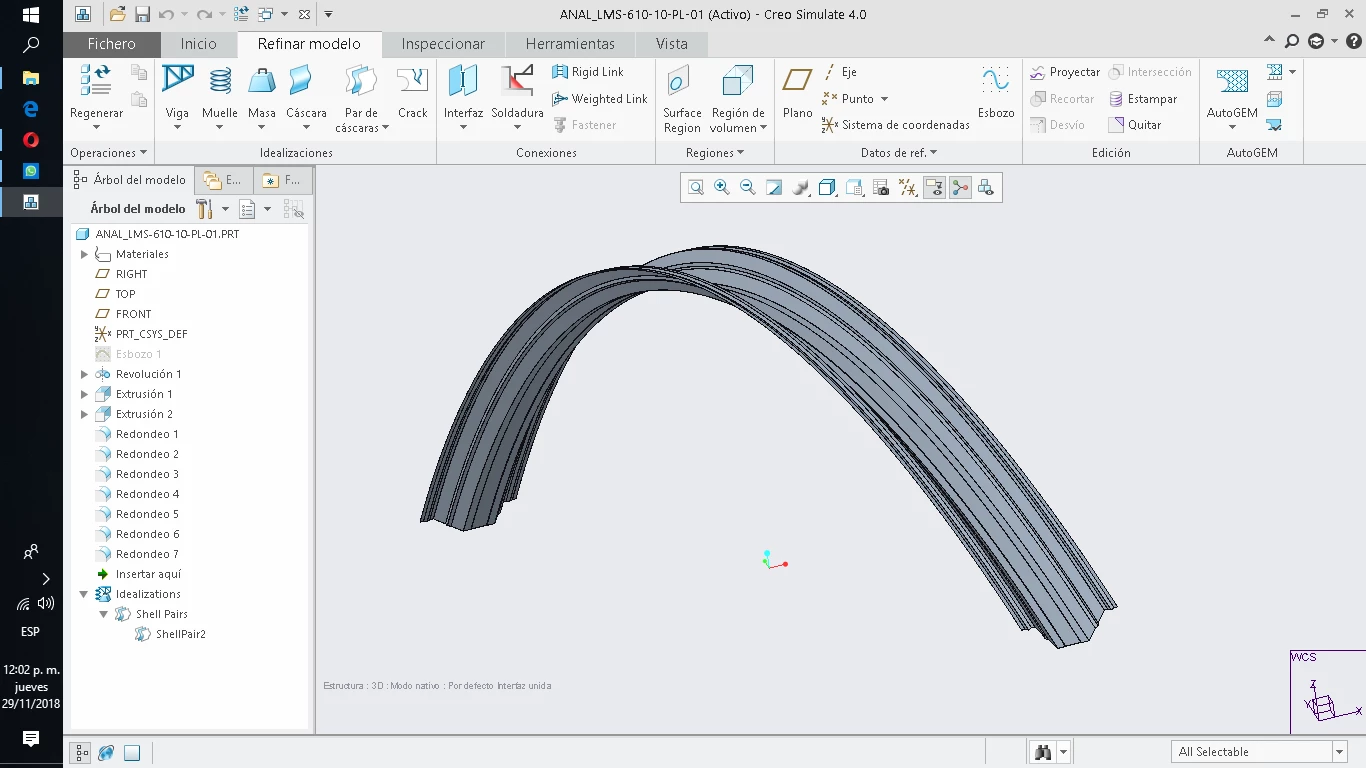

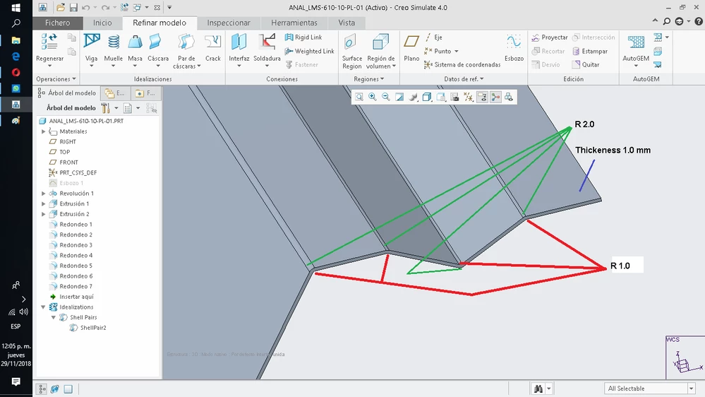

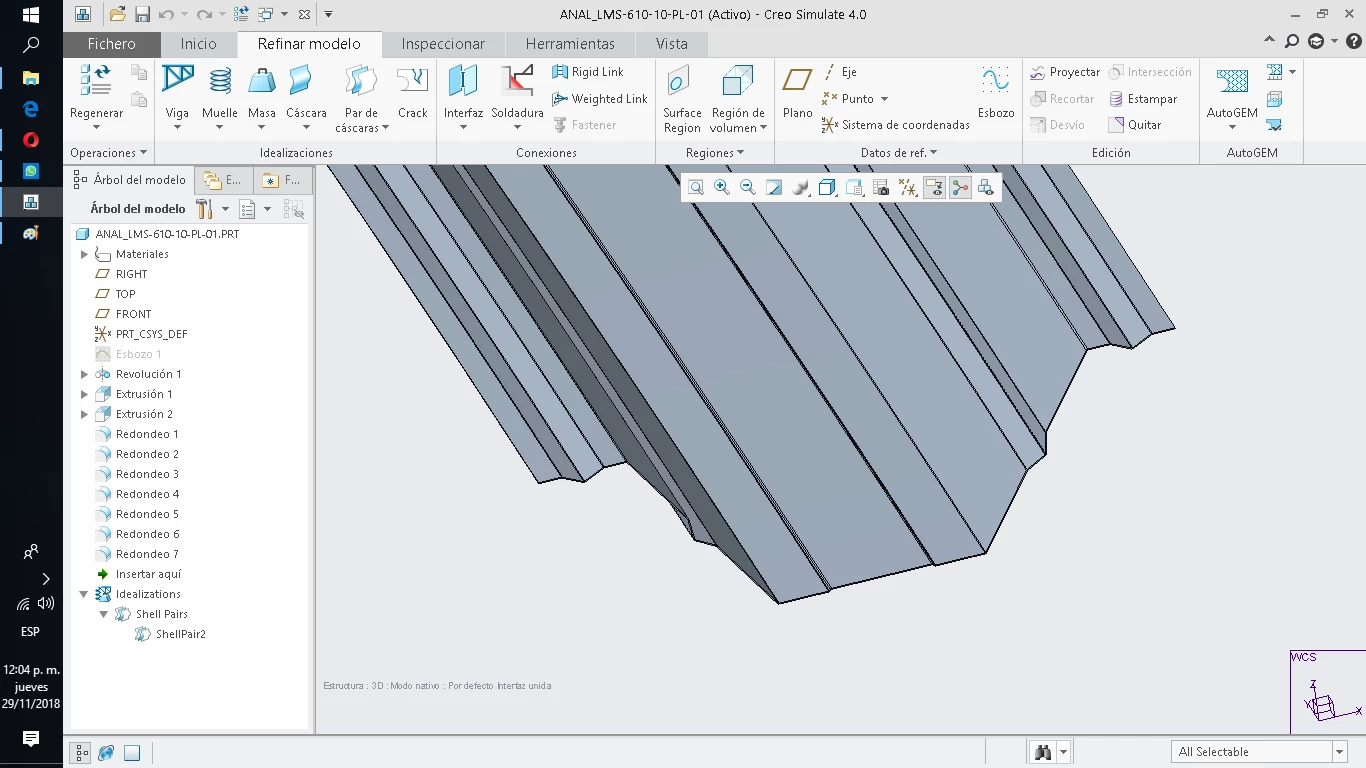

Hello

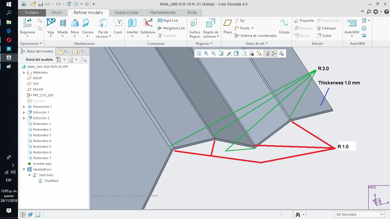

1.- When using Detect Shell Pair it does not detect the filletes (R1.0 and R2.0)
The surface is not completed.
What is the problem ???
The whole model is made in PTC CREO 4.0

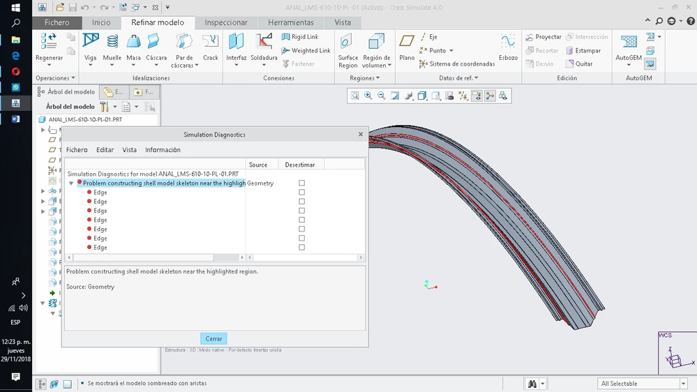

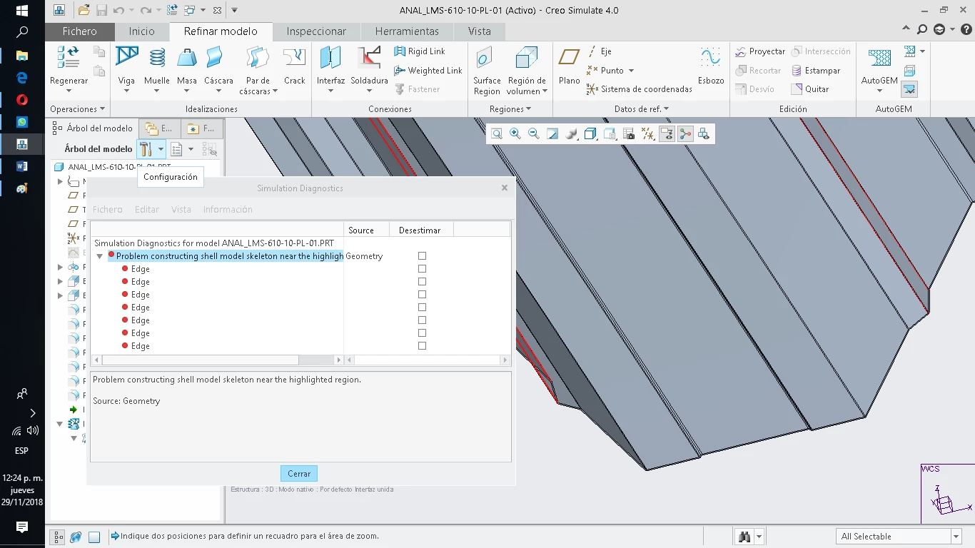

2.- By using Shell Pair manually and with the option to extend adjacent surfaces, the average surface sought is formed.

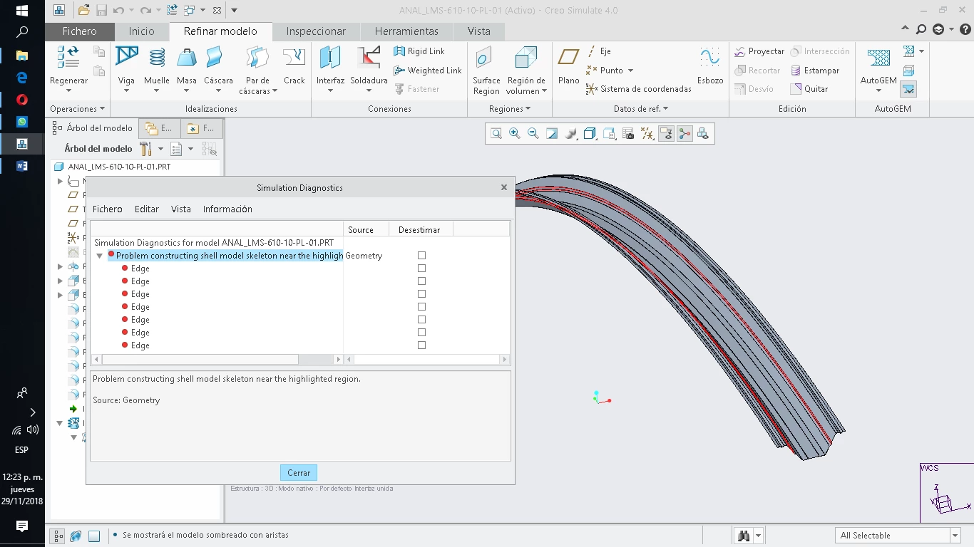

By using the AUTOGEM Review Geometry, it shows error in the edges
I have adjusted the absolute and relative precision variables, to be able to form those fillets (R1.0 and R2.0).
I assume that some variable needs to be adjusted in order to achieve the mesh of the average surface.
Regards
Carlos Mora L.

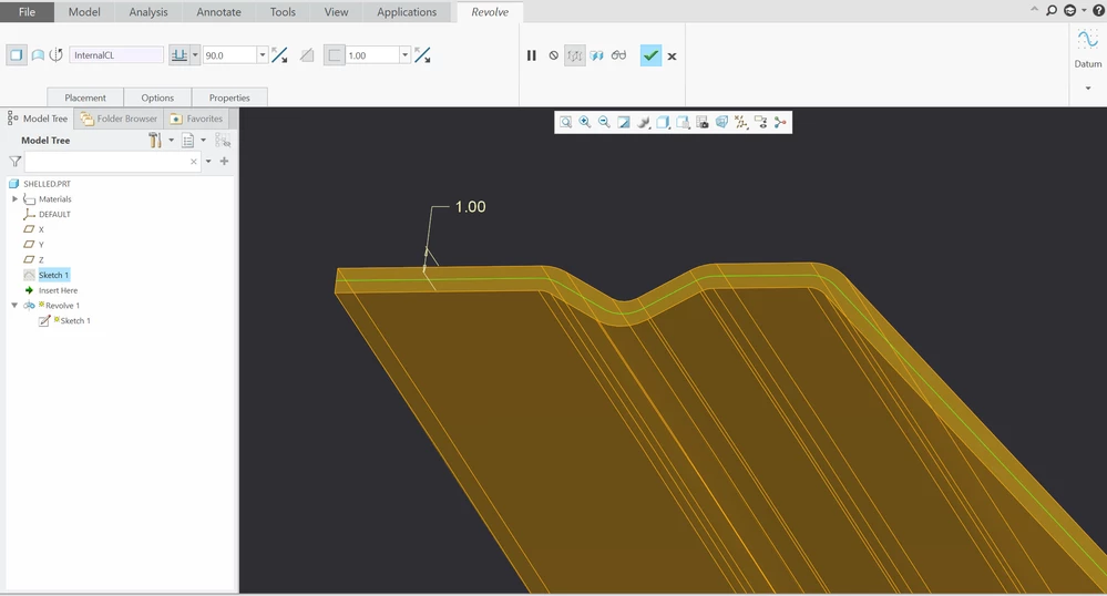

The problem is with modelling.
My understanding is that auto-detect only detects thin solids, shelled solids, and thickened quilts.  Your rounds are not made by these.
In my opinion a good modelling practice would be to include the fillets in the revolved cross section even if not simulating.
Thin solidAutomatic ShellAutomatic Shell
Consider whether you need to model the small fillets.

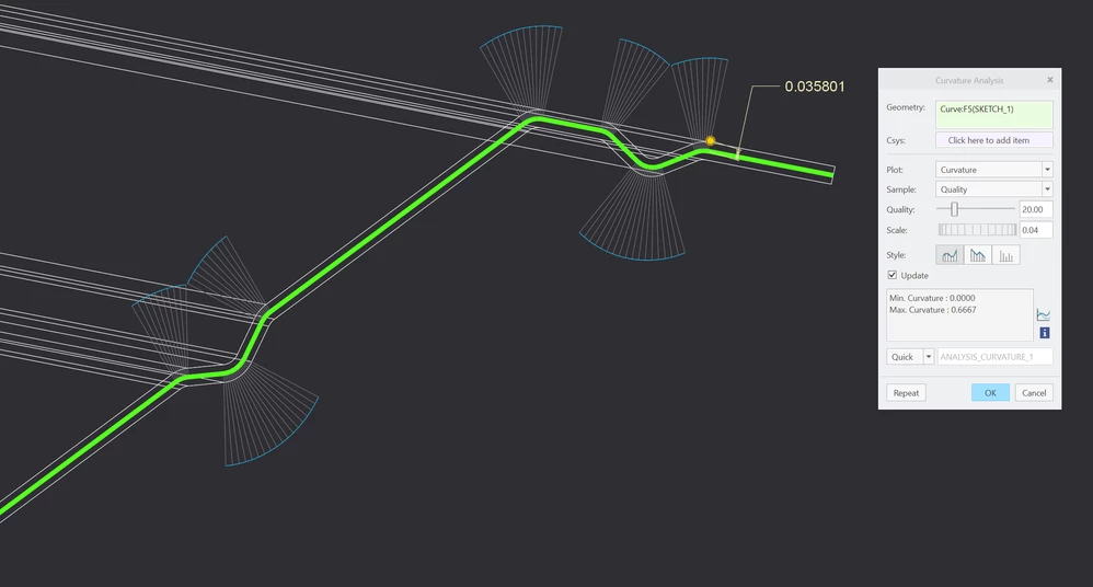

Thanks gfraulini.
According to this documentation, the curvature is OK but getting close.
http://support.ptc.com/help/creo/creo_pma/usascii/index.html#page/simulate/simulate/modstr/props/reference/sh_thickness.html
Note: Use the midplane surface for the curvature analysis.
This design is curvature 0.667 * thickness 1.0 = 0.667 < 1.5 so it is OK.
According to this the minimum radius would be 0.17 (0.67mm radius at the midplane)
Curvature MeasurementCurvature Measurement

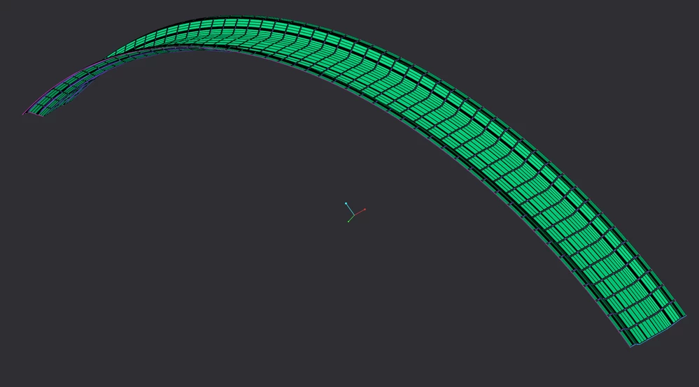

I personally would not use shell pairs, I would use a quilt with a shell property.  That would allow a mapped mesh with only quads and a much better mesh and faster simulation. The number of elements and whether I included the small fillets would depend on what I was trying to accomplish.  If this ends up as a wheel with spokes on a full model of a bike I would include less details.  If I was only interested in deflection/stiffness/mode shapes I would omit the rounds.  If I was doing a design sensitivity study I might check the difference with and without rounds and then decide whether to include them for a multiple-run type of study.
mapped quad shell meshmapped quad shell mesh
