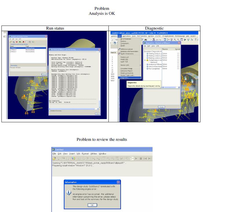

Hi everybody
I just created a static analysis with Pro/mechanica ( with Wildfire 4) and I face 2 problems
in the results
1 ) in the folder " diagnostic" , I have a message sayinf the contact area is small in comparison of the size adjacent elements
2 ) in the folder " run status'" , I have a stress error of 16.3 % ( according to PTC the maximum must by 5%)
To solve the firstr problem , I have cteated a control AUTOgem on the 2 faces included to define a max size of the elements , I want to know if it's the correct method or if an other one is better ( witch one ?)
For problme 2 , I don't know what to do , I have just notice that with the AUTOgem control to solve problme 1 , the % of stress error decrease to 12.3 % , bt I dont kno wwhat I have to do to be bellow 5 %
If anyone konw the solutions for my 2 problmes , it will be great if you can explain me
By advance , many thanks for your help
Olivier

May 4, 2012
Dear All
after some testings , I have now a stress error of 4.3 % ( I simply play with the limits of the autoGEM parameters )
Now I face a new problem , when I want review the result , I hav a window with the text " none of the windows of results selected can be show "
Do you know or did you already face this problem and if yes do you have a solution for it ?
Olivier

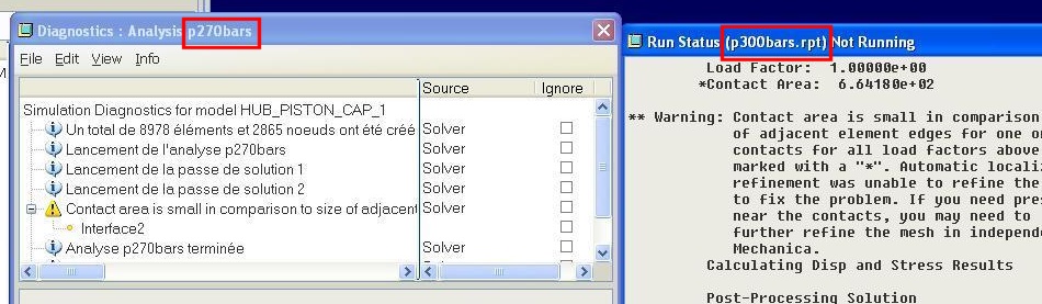

May 9, 2012
Bonjour Olivier,
I see something strange in your picture:
the name of the analysis in the diagnostic window does not correspond to the one in the run status window.
Your problem of results could maybe come from this issue.
opavot3-NewcomerAuthor
3-Newcomer
May 23, 2012
Dear All
Sylvain is right , I have mixted 2 studies in my picture but the problem true
For more information , I have checked the "status studie" and the " diagnostic " files
they are OK wit the sentence " run completed " at the end
Now mayby the file is too big for my computer but I don't know the way to check it
If you could help me
Best regards
Olivier
May 23, 2012
Olivier,
Take a look in the analysis report file. It has a .rpt extension.
It's located in the directory created for the analysis results.
Open it up with a text editor. Torwards the end of the file you should see a heading called
Memory and Disk Usage:
Look for a lines called:
Maximum Memory Usage (kilobytes):
Working Directory Disk Usage (kilobytes):
Compare these values to your Windows Task Manager: Commit Charge Limit (k) value and your free harddrive disk space.
This should shead some light on if you are running out of memory or disk space.
