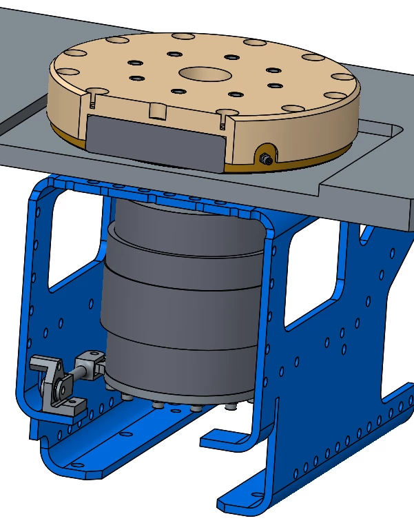

I'm having some trouble with Mechanism functioning properly and I'm hoping you can help solve my problems. Refer to the images below.

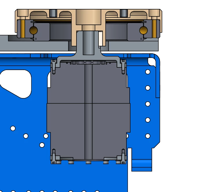

I have a subassembly (called top_cover_2.asm) which includes the following items...plate, bearing assembly, and motor assembly (which has 2 adaptors and a servo motor assembly). The bearing assembly and the servo motor assembly have been defined as pin joints to allow rotational motion. The top_cover_2 assembly gets attached to a frame part (3245298-002.prt). Once attached, I need to attach a clevis bracket which completes the connection from the bottom half of the motor back to the frame.
The problem originates when I try to attach this clevis bracket, it locks all rotational motion even though the top half of the servo motor should be able to rotate with the upper coupler, turntable, and outer bearing race. If I don't attach the clevis bracket, I can rotate the outer bearing race but the entire motor (top and bottom half) will rotate also, which is not how the system should function.
Could somebody take a look at my files and see if you can fix the problem? I have had no success yet after trying a bunch of different things. I'm running Creo 2 M150.
I attached 2 pictures...it wouldn't let me imbed them.
The top level assembly is called TROUBLESHOOT_ASM.asm

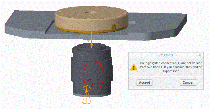

I got the problem solved. I finally heard back from a PTC engineer and he was able to redefine the connection of the motor assembly (8179-2.asm) to the turntable (T7_TURNTABLE.prt) inside TOP_COVER_2.ASM using a total of 3 general style mechanism constraints. The first 2 general constraints (in constraint set #1) were an insert and a mate (to set the depth of the motor assembly with respect to the turntable). The second constraint set was a general constraint to set the clocking of the motor assembly at the keyway surfaces.
The clevis rod (J1_CLEVIS.PRT) was then modified to have 2 constraints. Basically they were insert connections between the rod ends and the spherical bushings.
New model tree should look as follows...

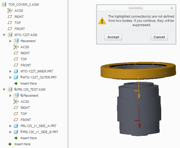

Something is going on with the motor's internal connection. When assembled into the top cover assembly it loses it ability to rotate.  Trying to figure out why...

Interesting.  I have seen issues in the past with insert connections causing issues.  The "allow assumptions" seems to create a hidden constraint back to the global coordinate system that can lock things up.
I've actually whittled this down to just the motor halves and the bearing (using only planar constraints) and I'm still getting the error.  It's really bugging me now, so maybe I'll open my own case with tech support.  (If you can tell me your case number or tech's name, I will try to reference that.)
