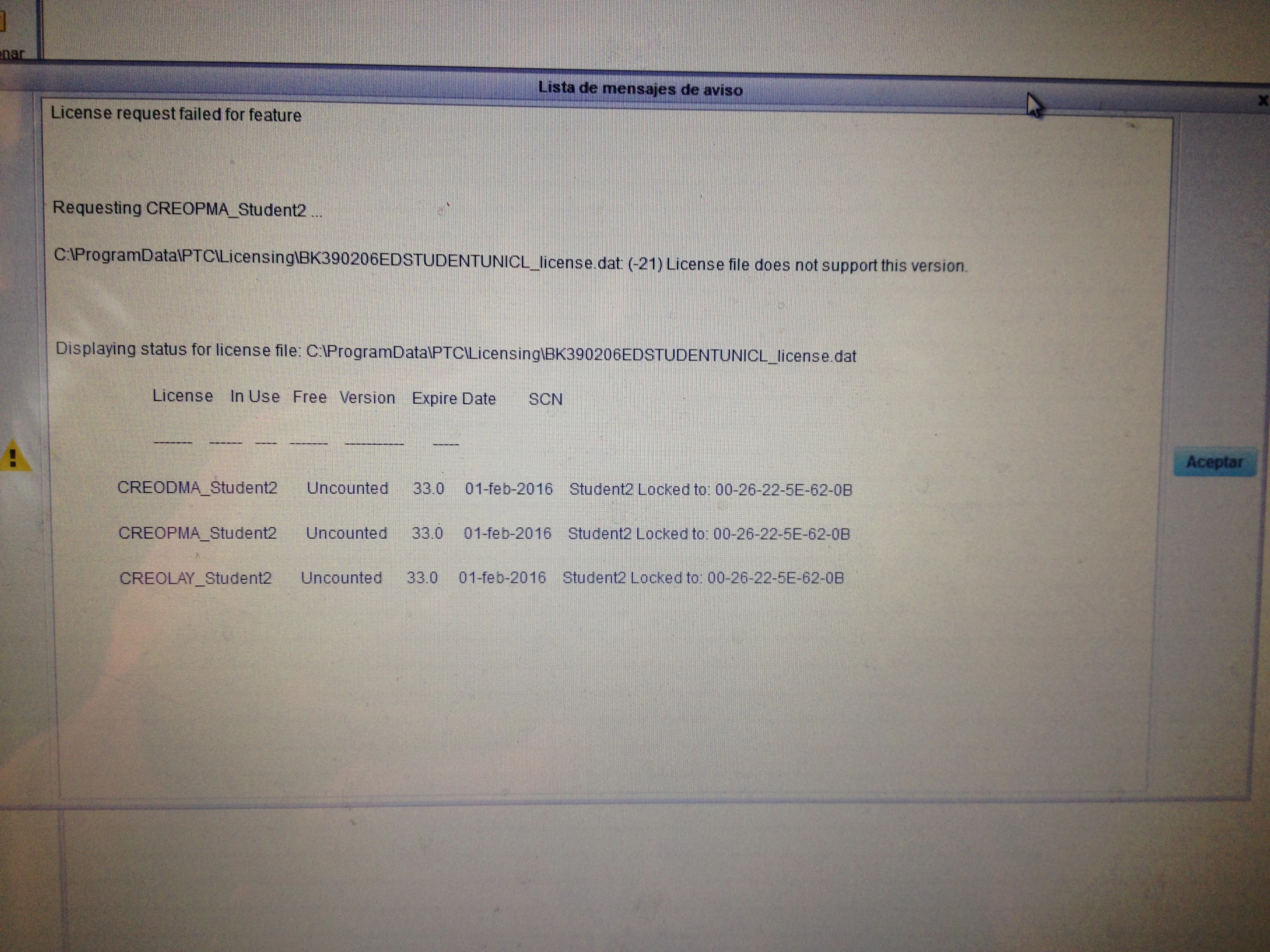

I have problems with the product code. I've installed creo 3.0 using a student licence. When I start Creo, a warning message prevents the progam from running. And says: the licence does not support this version.
What i need to do?
Best answer by TomD.inPDX
Creo 3 is version 34. Your license is for version 33.
