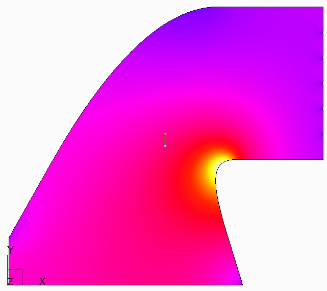

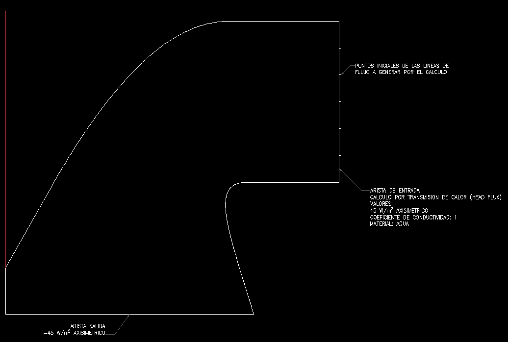

I've a customer that ask me about Thermal Analysis axisymmetric
I've the load input (Vertical Line 45 W/m^2) and output (Horizontal Line -45 W/m^2)
The constraints temperature is 25ºC
The material is water... Then the properties of water for Coef. Poisson and Young Module are similar to Steel ( a small cheat )
The result of Flux (W/m^2) is this.... initial in yellow curve zone and finished in output horizontal line... when should begin in input vertical line and continue to output horizontal line.

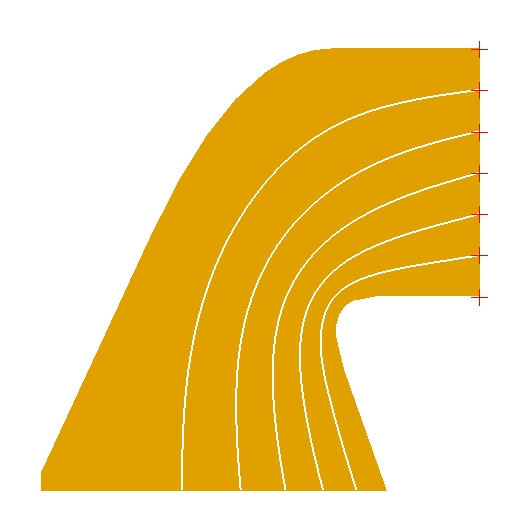

Also I should get the curves that go from line input to line output... as example this image of customer.
Who can you help me?

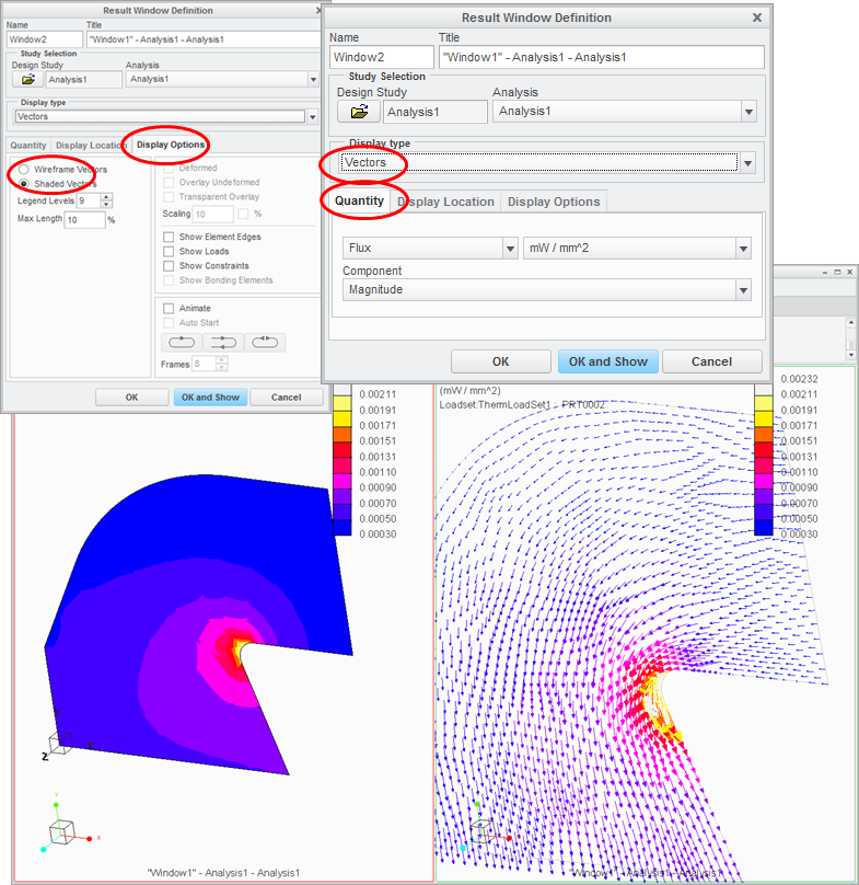

Does this help?

I need to get the "curves" 2D from input to output. These "2D" curves are to design the 3D model.
Thanks... I hope can you help me.... or other colleagues too.

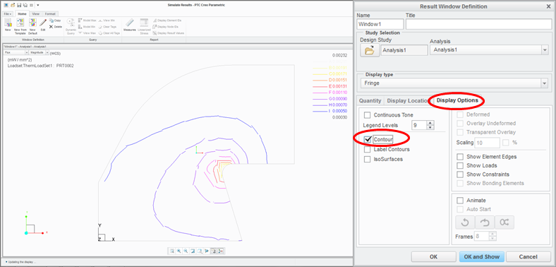

Gorka,
Do you mean contours of equal flux?
