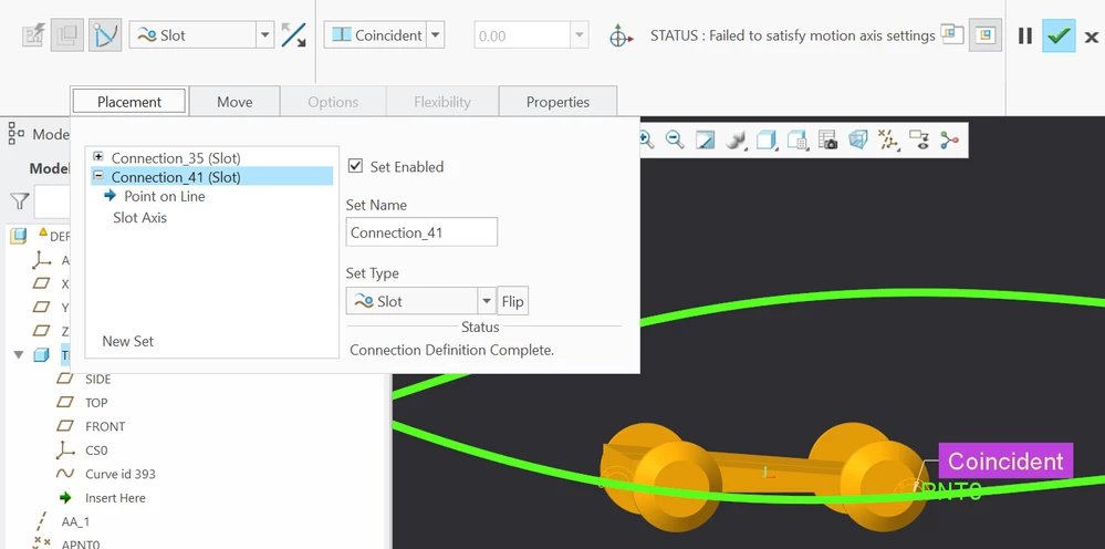

I used two slot connections, one front, one rear, then an additional artificial component for orientation.

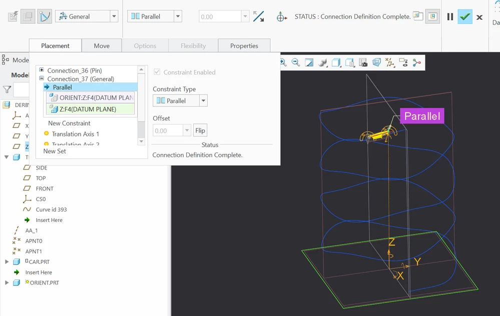

The orient component was connected with a pin joint to the car and a parallel constraint to the ground plane.
The pin joint allowed the car to tip up/down but not side to side.

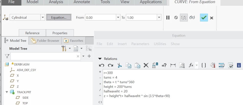

For bonus I added a sine wave to the helix and friction and bumper at end of travel.

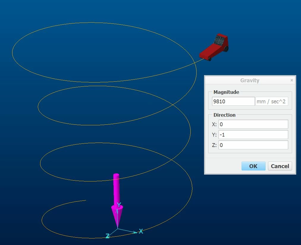

Note I used -Z direction for gravity.

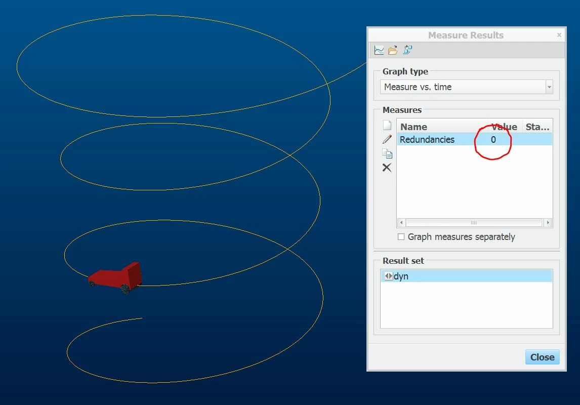

"...additional artificial component for orientation..."
very good.
what about "Redundancies"?
August 7, 2018
oops!
Redundancies = 2
