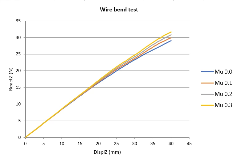

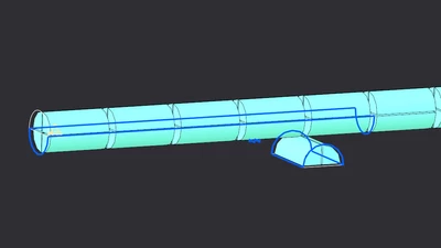

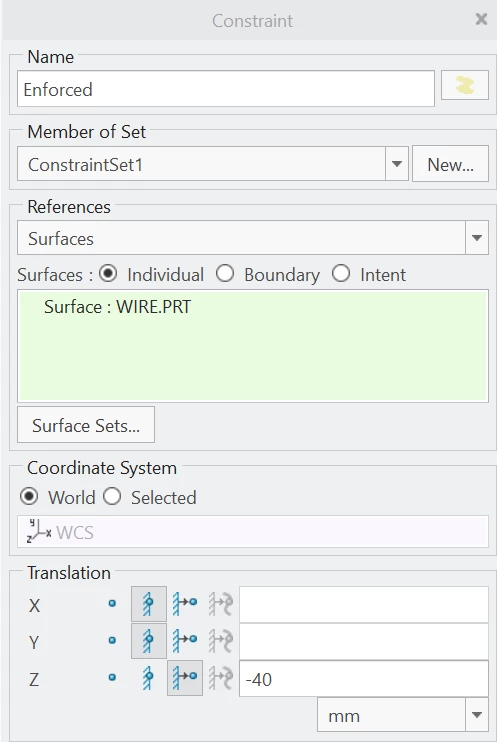

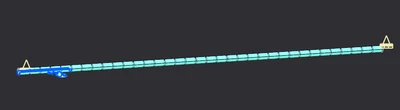

 BELOW IS MY ANSWER TO THE QUIZ
Mu is the coefficient of friction static=dynamic
Contacts, prismatic elements, and left end constraint "in plane"
Right end constraint for symmetry and enforced displacment.
SOLVE TIME APPROXIMATELY 100 seconds.

what about z=-100 mm? (oddly interesting effect)
August 9, 2018
yes, I see a maxima around 85mm,  47N for Mu=0.3
