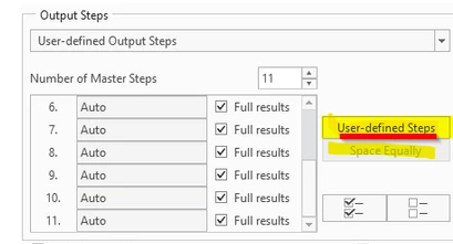

@SweetPeasHub Why does setting the User-defined Output Steps help the solver from converge instead of setting Plotting Grid or Polynomial Order?
skunks
skunksAnswer
better user-defined steps, for example 0, 0.1, 0,2 ... 1
skunks
a quote: "Simulate has a built-in automatic load step refinement in case of too big increments, but this should not be overstressed!
A good user load stepping can significantly increase performance!" (Dr. Jakel)
Joey_Chen11-GarnetAuthor
11-Garnet
Thank you for your kindly reply, sir.

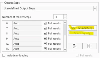

For better convergence in the User-Defined Output Steps, should I choose Automatic or User-defined steps?
skunks
skunks19-TanzaniteAnswer
