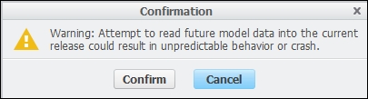

Evening All,
Has anyone come across this ...
The model was originally created in Creo2 M130 (customer)
I loaded into and ran it using Creo2 M100 (a quick review without having to install M130)
The message pops up when I try and read results I just created in M100
Being brave and confirming reads and displays results ok.
It's not a major problem; more a curiosity.

My test in Creo 2.0 M080:
curiosity...

I think I know what it is saying. It recognises the model being read is from a newer edition of the software. Given they are all Creo 3.0 it isn't really a problem in our examples.

I think it's modification of  contact analysis:
sim_contact_penetration: the meaning of this config.pro option
as well as the engine command line option (-contact_penetration) was different before Creo 2.0 M100
