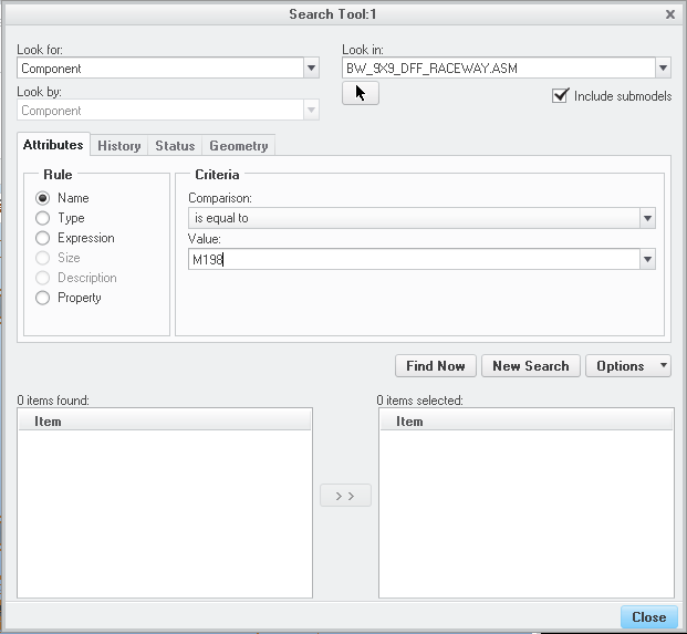

vzakAnswer
September 10, 2013
Hi, try another 2 options in the search tool as in the picture above :
1. Go to "History" tab, look by ID = 198
2. If not found, in same History tab look by Feat Number = 198
If still not there (and given you have Yellow regen sign) - try to look by Status = Frozen.
Best,
- Vlad

Have you tried using the "search tool". Set the "look for" feild to "component" and enter your value of "M198"SEARCH+TOOL.png

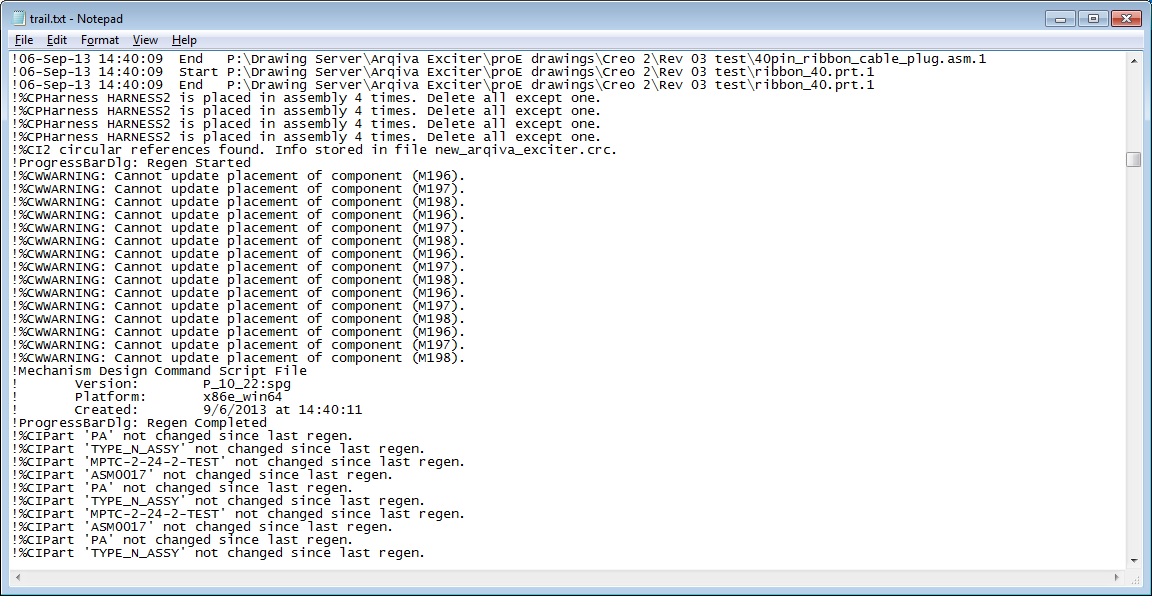

StephenW
September 10, 2013
Usually what I do in cases like this is open the trail file and search for "cannot update placement" Usually it gives you more information about what component is failing.
For example, the assembly I am working on right now shows this in the trail file:
!%CWComponent id 495 of model 20015508_DOORS_OPEN is family table driven and will use pre-Wildfire3 replace functionality
!%CEFailed to replace member 168111 (M495), 20015508_DOORS_OPEN.
!%CWWARNING: Cannot update placement of component (M495).
!%CWComponent id 497 of model 20015508_DOORS_OPEN is family table driven and will use pre-Wildfire3 replace functionality
!%CEFailed to replace member 168111 (M497), 20015508_DOORS_OPEN.
!%CWWARNING: Cannot update placement of component (M497).
It tells me what model is failing. In this case, another engineering groups part (not mine, my stuff is perfect...LOL), apparently did a family table to open a door and something about it is failing.
September 10, 2013
Stephen,
I tried that and I found them, but all it says is "cannot update placement of component (M19X)". It doesn't state where in the model or subassemblies that component is found.
StephenW
September 10, 2013
Funny, mine looked exactly like that but just past that part, it gave me the additional information.
September 15, 2013
Using "Solid Model" to find "M198"
