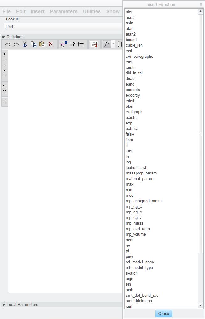

May 10, 2013
The most comprehensive list is in the relations dialog itself. In the help file, they are sprinkled all over the place by operation.
