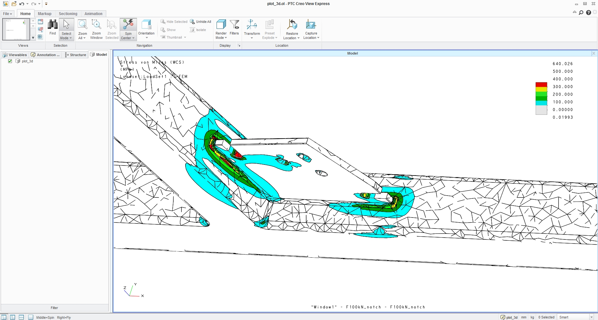

Is there a way to overlay fringe results with isoline (Creo3)?
I want to have a black line separation between my color spectrum.
Thank you for any tipp

little workaround:
export of plot as creo view
open with creo view express
regards

Hello Paul,
Thanks for your workaround, which I already knew it.
I was wondering, if it was possible to do it direct within Creo environment.
skunks
May 19, 2017
unfortunately no.
regards
paul
