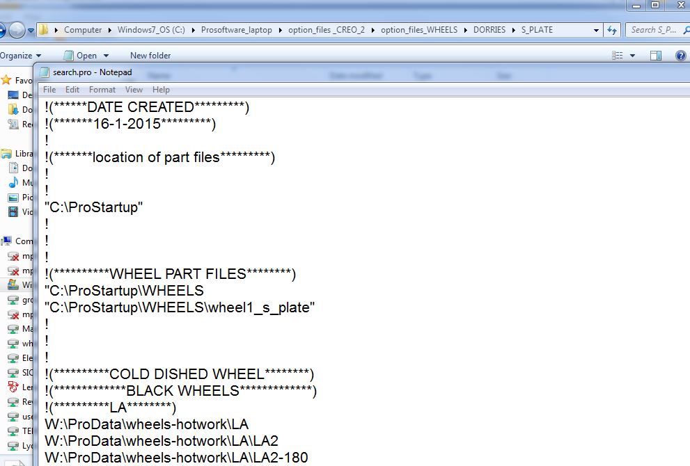

Hi All
I have a problem with finding files with directory paths in Search.pro
As I work with the manufacturing side of the software, I have multiple option files and search.pro files set up for all the machines in the manufacturing process.
at the moment it is around 22 sets of files.
This has been working ok up til now...
We had been orginally using one .prt file to control all of the variation of products by family table, some 600 different parts. This became to unstable, so we split them along family groupings into six .prt files. now the search.pro file was managing this without problem, until this arrangement became to unstable, file just getting to big to manage.
We are now spilting the .prt files down into small groupings with very small family tables. so basically we have gone from one file, to six files, now to around 300 files.
This is where my problem now starts.
This mean each time a new part is now added, I will be force to edit all of my search.pro files to add the folder location of where the part is stored.
I have tried to list the top directories of the part files locations in the search.pro, but it won't find parts in sub folders...
is there a way to force Creo to search all sub folders below a directory that is listed in Search.pro
or do I have to spend a big part of my time to undate the search.pro every time a new part is created, not very productive
Now I had created one set of option files and search.pro before, but due to the size of our system, it just slowed eveything down, so I was recommend by our PTC support contact to have seperate search.pro files
so my question, is there a way to force it to search every sub folder, without having to manaully update the search.pro file

Best answer by Wheelsofsteel
Since I posted the original post, I had created some excel spreadsheets with VBA in them, and I currently use it when I do my weeekly planning on fridays.
it searchs the directory and list every folder under the parent and creates a list
I then paste this into another excel file that has the fixed paths that don't change.
Then this one create a new search.pro file from that info with a date at the top and saves it in the option folder for each start up shortcut I have.
Still needs work, need to combine into one file and make it a one click operation, but its functional and makes life a bit easier.

Currently my search.pro is set to search the top level folders, it just mean, I would have to add every single subfolder, to every search.pro, every time a new family part is created.
the old system which was 5 .prt files based on wheel styles, while stored on the main network, I would copy to my c:\ drive to work locally.
So my search.pro was
!(**********WHEEL PART FILES********)
"C:\************\WHEELS
"C:\************\WHEELS\MAIN_curve"
"C:\************\WHEELS\MAIN_straight"
"C:\************\WHEELS\MAIN_reverse"
"C:\************\WHEELS\MAIN_disk"
"C:\************\WHEELS\MAIN_ciu"
and as such never altered when new parts are created.
