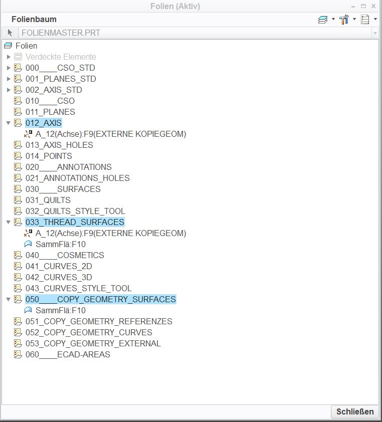

the search function (STRG+F) in PTC Creo or ProEngineer is mine and certainly well known to you. Basically, I get clear with it and find also my things which I have to look for.

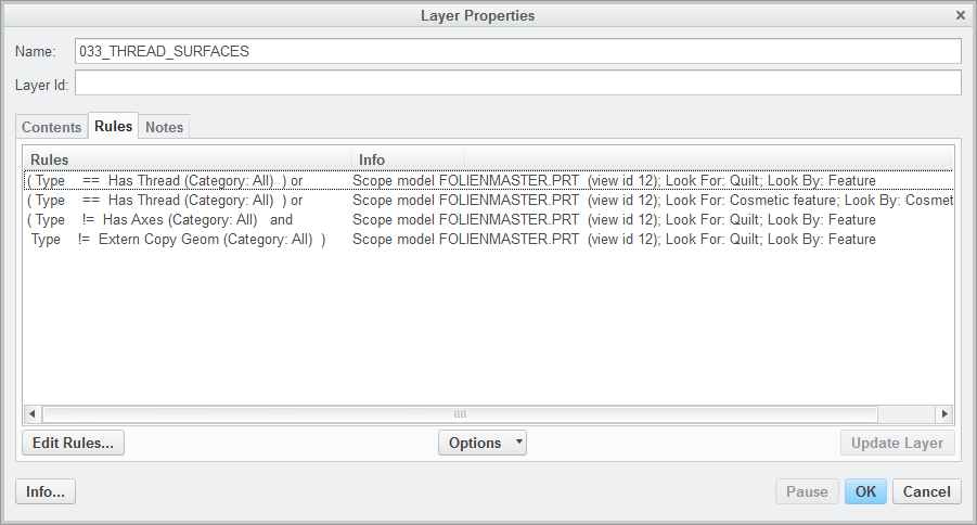

However, I am currently trying to define predefined searches, which I would then save as a rule. As a rule in layer management, to define a layer master.
To properly include and exclude the various KE's, surfaces, references, cosmetics, notes, etc., the associated rule must also be properly defined and excluded. Otherwise, any of the elements not belonging to the layer will be added to the layer. And right here is my problem.

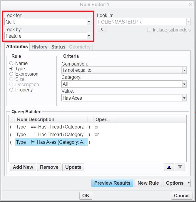

Because somehow the settings of the search do not really open up to me. In particular, I mean the "Look for" and "Look by" drop-down boxes. Can someone explain these fields to someone more precisely, because even the PTC Consultant who was in our house, could not explain to our satisfaction. In this context, I also wonder why a logical rule for Creo is wrong or can not be generated.

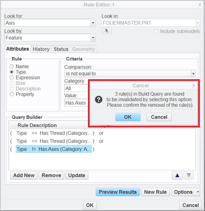

With "Look for" you choose what you want to get and with "Look by" you tell Creo how to go about it.
"Look by" determines which options are available in the tabbed section of the dialogue.
Layer rules at my place of work mainly look for features with certain attributes (type is equal to X, has thread, name is not equal to X, ...)
I figured out that this causes some small issues when using inheritance, so I tuned my rules for datums and threads to look for the datums and threads themselves instead of the features containing them.

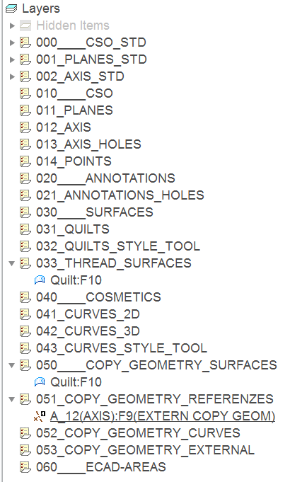

B.) The definition of the layer rules I get more or less. However, it makes me have problems when I have defined a rule and then have some features when creating or importing into layers that they do not belong to. Some of them are also available twice. So in 2 layer at the same time. This can be seen in the example. The axis A_12 has been imported as a copy geometry. Unfortunately, this is now in the layer "033_THREAD_SURFACES" and "012_AXIS". I would like, however, that this axis (like all references) is located in layer "051_COPY_GEOMETRY_REFERENZES" and only in this layer. From all other layers this axis should disappear.
The same is it with the Quilt_F9, this one should not be shown in the layer "033_THREAD_SURFACES" because it is a surface from copy geometry.

I included axis into 051* layer and remove it from 012* and 033* layers. I cannot comment A.) and C.).

Ah, you are right - I see I missed the difference between A-* and A_* in your rules.  In general I think you are in the right track and only missed the difference between extern copy geom and copy geom.
For layer 033_THREAD_SURFACES, you didn't have a rule to exclude quilt thread surfaces from extern copy geom objects, like this:
And so the quilt F10 was showing in your layer.  With the above rule set, it does not.
