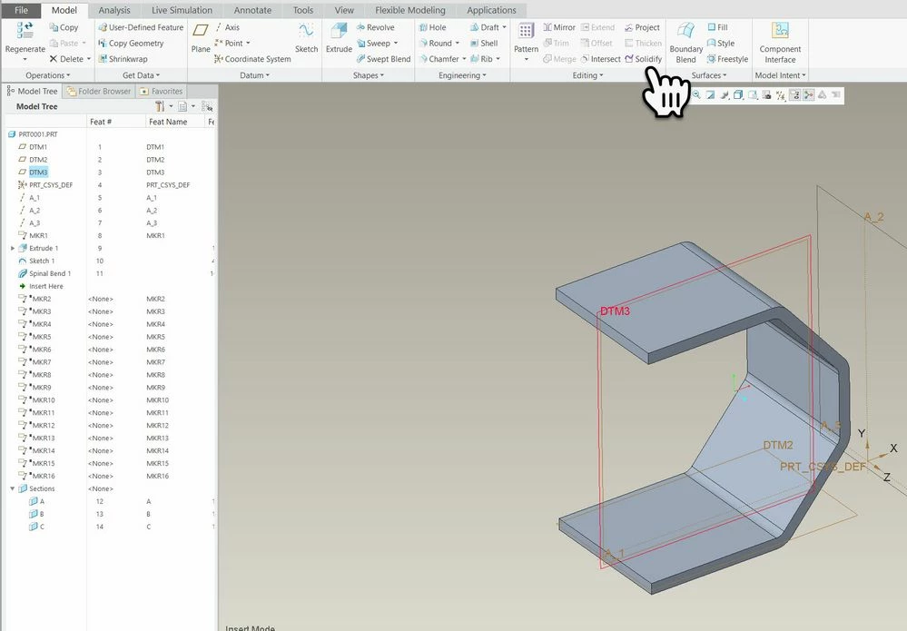

You can do it in part mode to prepare the geometry for analysis. If you have the default UI layout it will be in this location in part mode.
Solidify plane for cutSolidify plane for cut

You can use a symmetry datum plane to cut the solid geometry. Select the datum plane and then use the solidify option and select the side to cut away.

Thanks. Where is the solidify option you are referring too?
I guess one must do that in: Application/ Simulate
