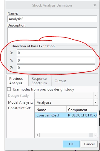

can you help me to understand the meaning of "Direction of Base Excitation"?

as the name implies, you define here, in which direction the spectral input you have, will work. The input you define in the 2nd tab. So if you have e.g. spectral acceleration defined with this you define for which direction of csys the acceleration will be applied.
http://support.ptc.com/help/creo/creo_sim/usascii/#page/sim%2Fsimulate%2Fanalysis%2Fvibrate%2Freference%2Fdir_base_excit.html%23wwconnect_header
