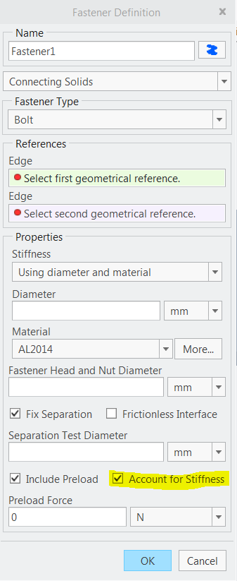

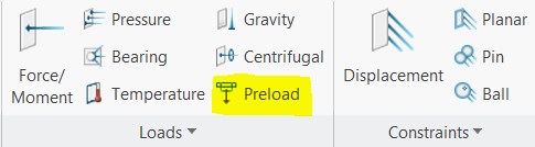

Hello All,
As Account for Stiffness option is available in Fastener connection while applying Preload Force.
Shouldn't it be also available in Preload while defining loads separately to a component?

jmoradiya1-VisitorAuthor
April 7, 2017
Hello Paul,
Thank you for your reply. Yes, I do have Creo Simulate 4.0

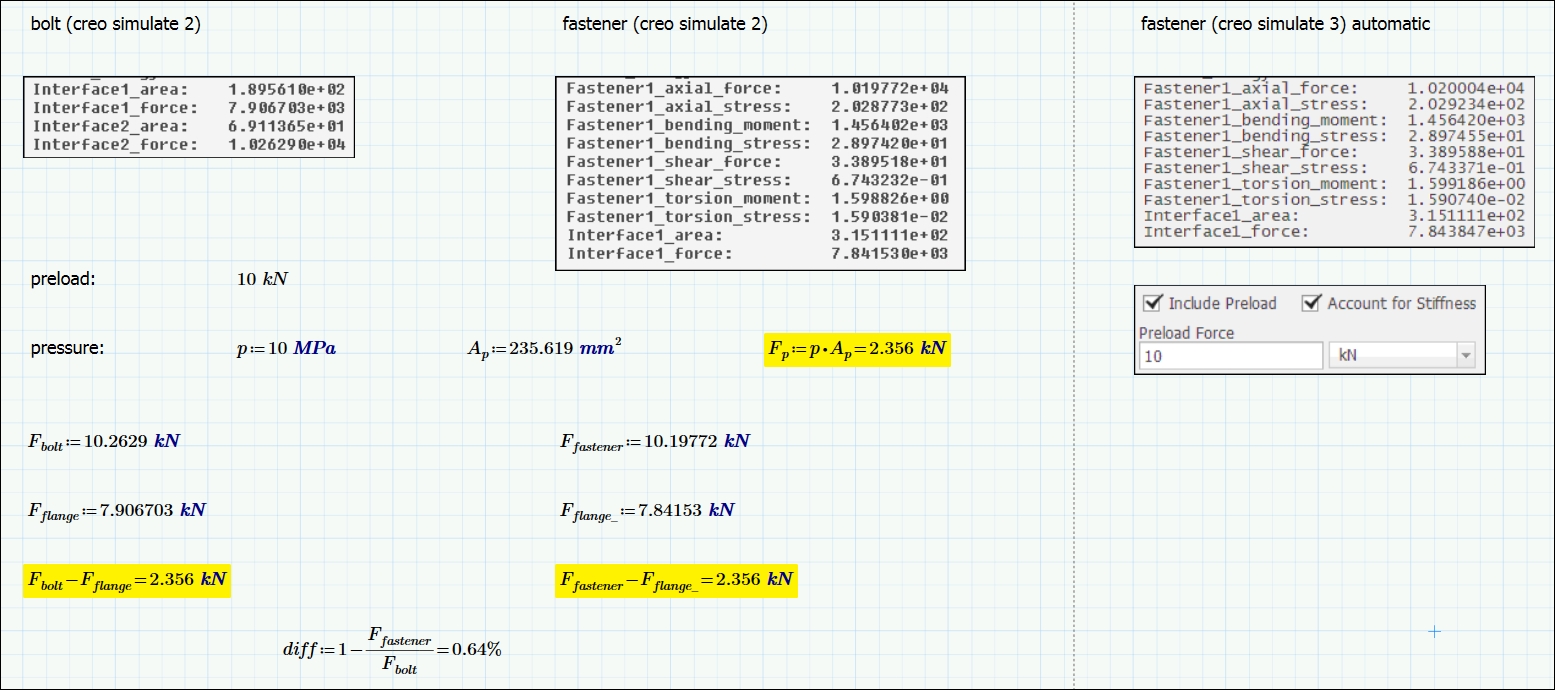

My question is about what could be a reason for not having a "Account for Stiffness" function in Preload while applying it separately? I mean if we apply preload separately then interface_force would be less than the actual applied Preload and we need to run static analysis once more to have desirable interface_force at the end. Isn't it?
What do you think?
Best regards,
Jignesh

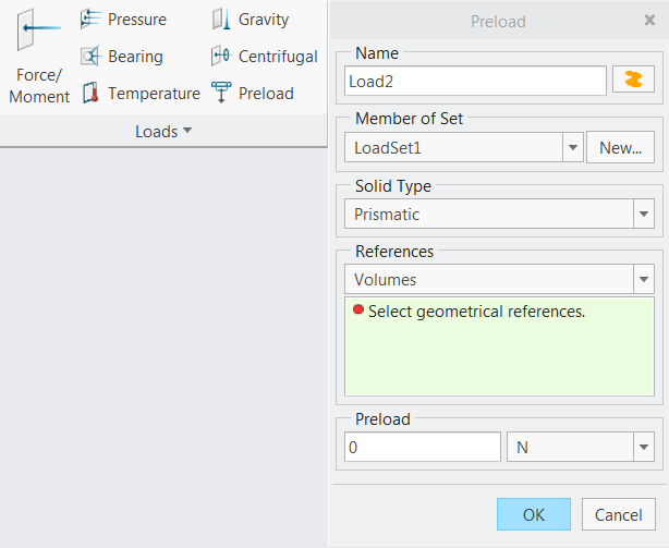

Hello all,
Thank you for replying.
I know the function of Account for stiffness and how to use it also. But when we apply preload in loads and constraints in model in Creo Simulate 4.0.
after clicking this preload, we get Preload Definition Dialog Box for example like below image
In this option, we do not get Account for stiffness which is available in Fastener connection.
So my question is, should't be there that option for getting actual preload in analysis?
What do you think, what could be the reason for not having that option in Preload?
Best regards,
Jignesh Moradiya
skunks
April 10, 2017
hello Jignesh
  • Fastener is a old feature, preload is younger
  • Fastener feature has a atomatically measure "fastener_axial_force", but preload don't have that
  • PTC don't have enough resources (code enhancements)
regards
