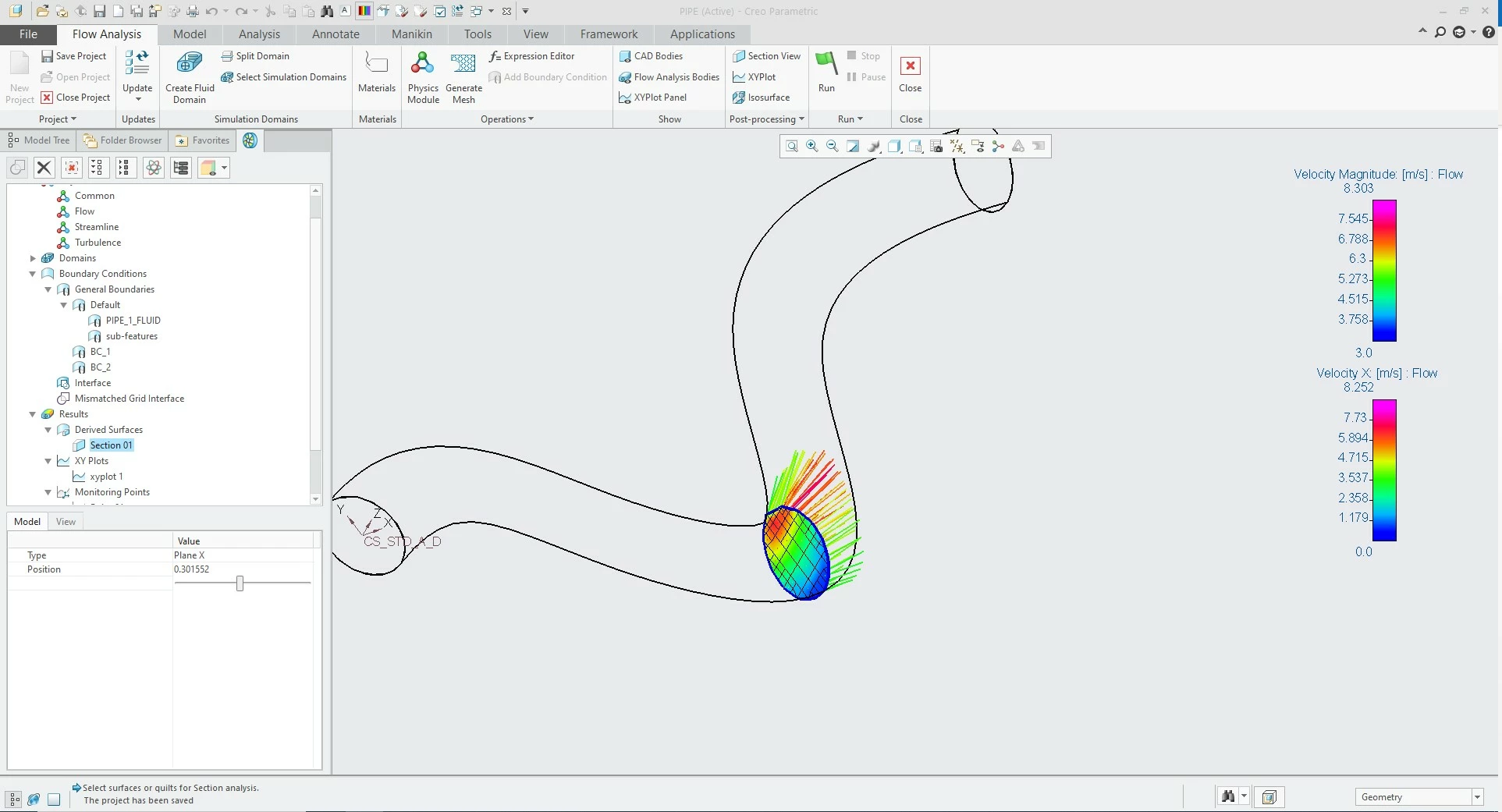

Is there an option to see exact values of pressure, velocity etc. in Creo 4.0? For example: If I create a monitoring point in a pipe, I would like to see the exact velocity-value "xy" at this point. I just can plot a graph.
My actual goal is to get an average value of an area with different velocities (like shown in the picture). I just have the rough information from the legend.
As far as I know, no. Indeed my organization has already signaled to PTC this (and other) lack. The only workaround is based on to see the colour.
Thanks for the response! That's unfortunate. Do you know if there is a possibility to get more accurate data?
I created several monitoring points and can see rough values in the graph. Maybe it is possible to export my graphs to excel to get a more accurate result?
The exportation is another thing we've required to PTC. Maybe with Creo 7 there will be more enhancements (also) on Flow side.
