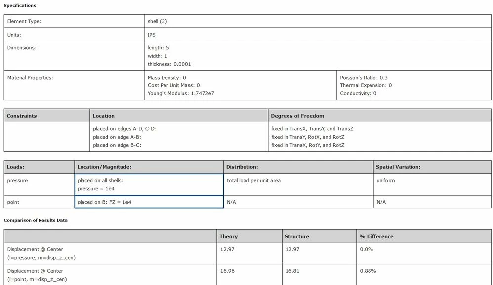

Hello all,
I am happy to be here again. Now I am having a serious problem with one of the examples of the verification guide of Creo Simulate. I do not understand why my simulation is wrong, I cannot get the correct displacement and I don't know if I am missing something. I will attach the model, the correct results and procedure are in the next image (or link - mvss001 exercise)...
http://support.ptc.com/help/creo/creo_sim/usascii/#page/sim%2Fsimulate%2Fverify%2Fs_static.html%23

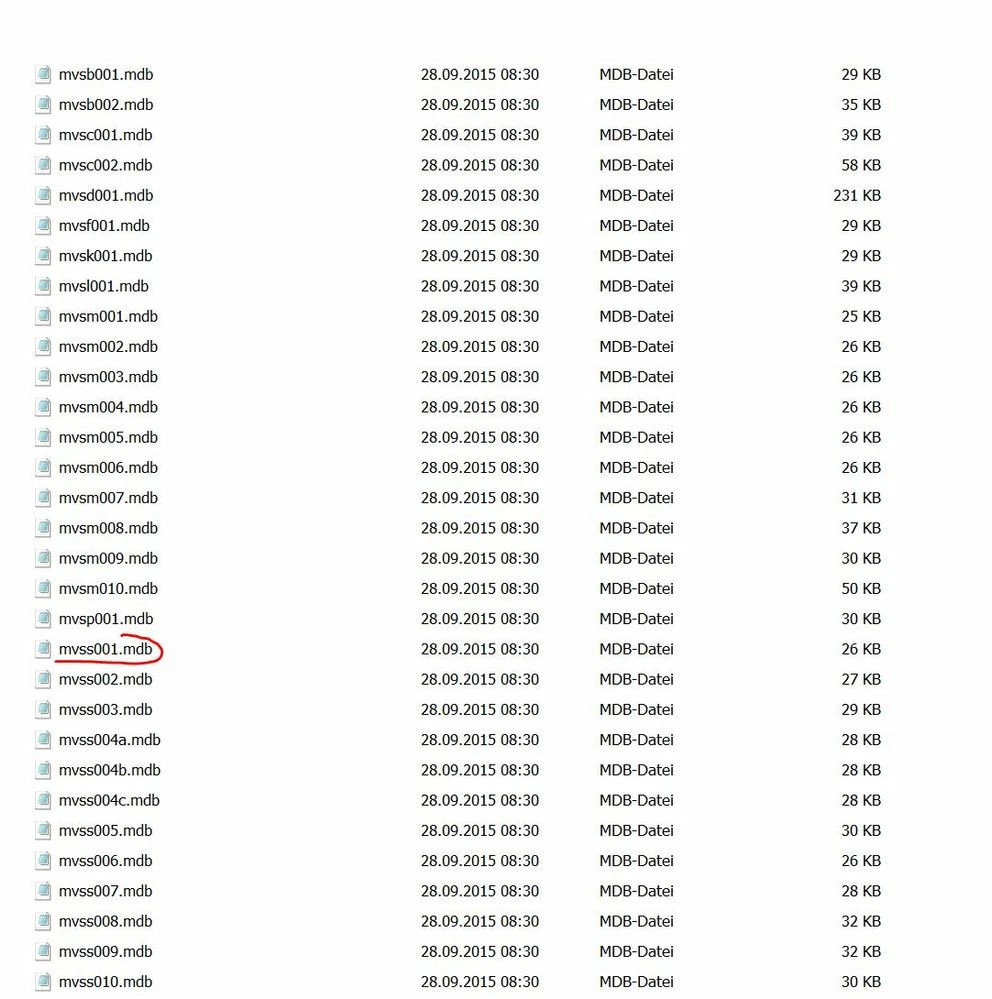

i don't have creo 4
example attached: L-01-61 independent mechanica

OK
You need MECHANICA STRUCTURE independent mode (xxx.mdb Database)
please install this befor Creo 2
regards

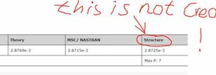

October 26, 2017
the verification guide is not creo simulate

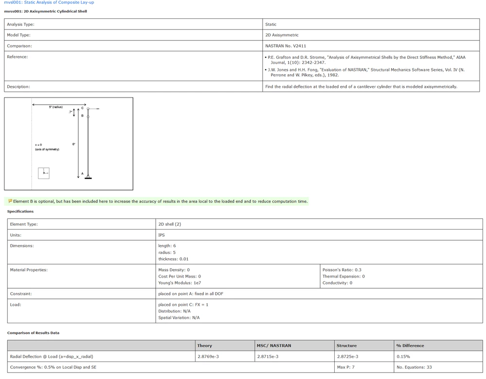

I am afraid that this is more complex.
Quoting from the web page "The Verification Guide uses a series of problems, based on finite element models and mechanism analysis models for which analytic solutions are known, to demonstrate the accuracy and efficiency of Creo Simulate in the design analysis process."
Now, the results that they have there, are correct. However, the guy that posted that page, did a lot of mistakes. Just replacing a + for a -, and the analysis fails. That's the reason why it was driving me crazy. Check this case for example (see image).
In that, I HAD TO GO TO THE REFERENCES to figiure it out that it was bad.
I don't have many sources to learn, and to answer the classic question, how do you know your analysis is correct?
Based on that, I can study this thing, and compare it with the guide, but well, if there are errors, it is like useless.
