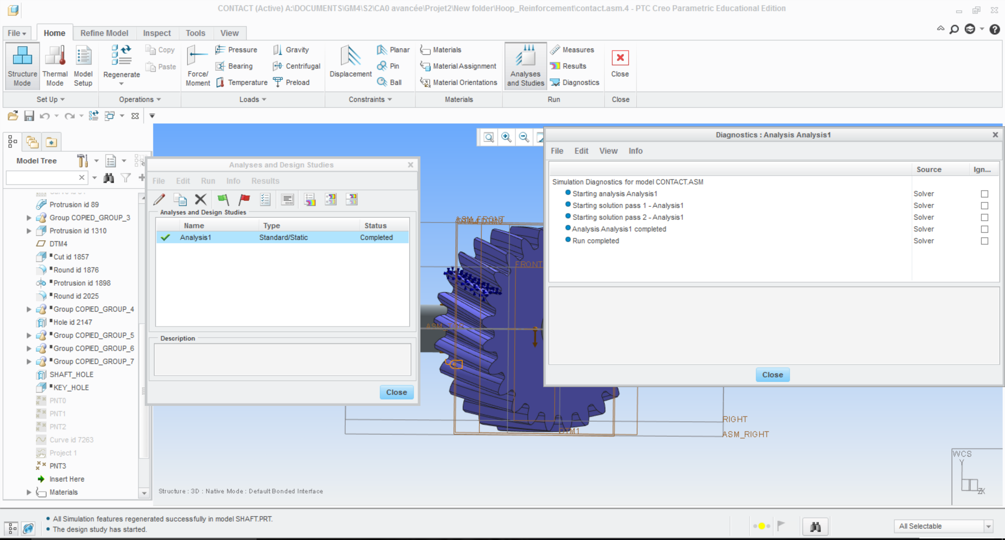

I create my model, assign constrains, forces, material and create static analysis.
Then I run it, it completes :
this completion comes very fast, and obviously i have nothing in the report log...but the green check is there.

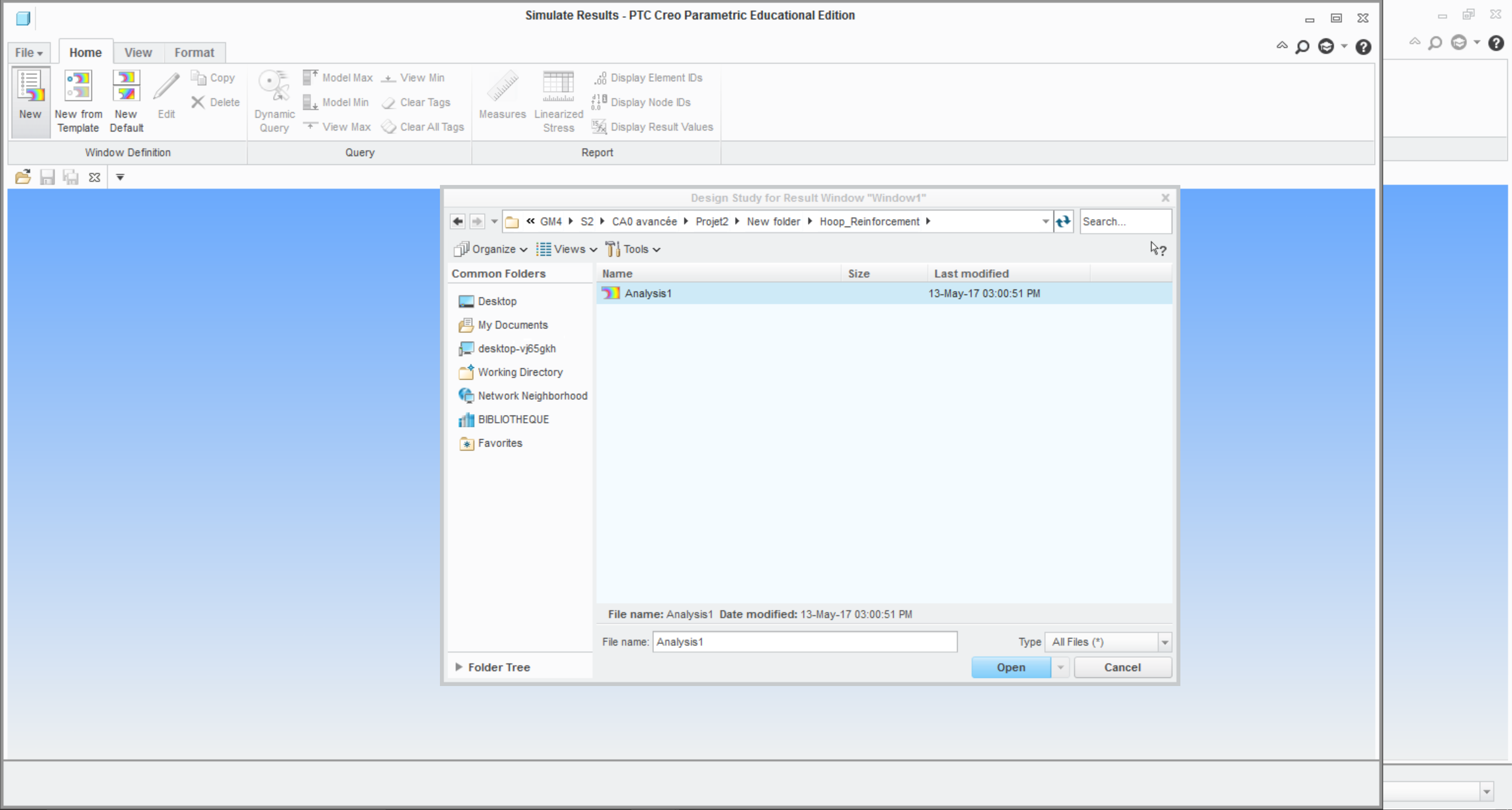

Then I try to open my results. At first there is no window to allow me the "Ok and show"...so I click New.
Once new selected, I see my analysis ready.

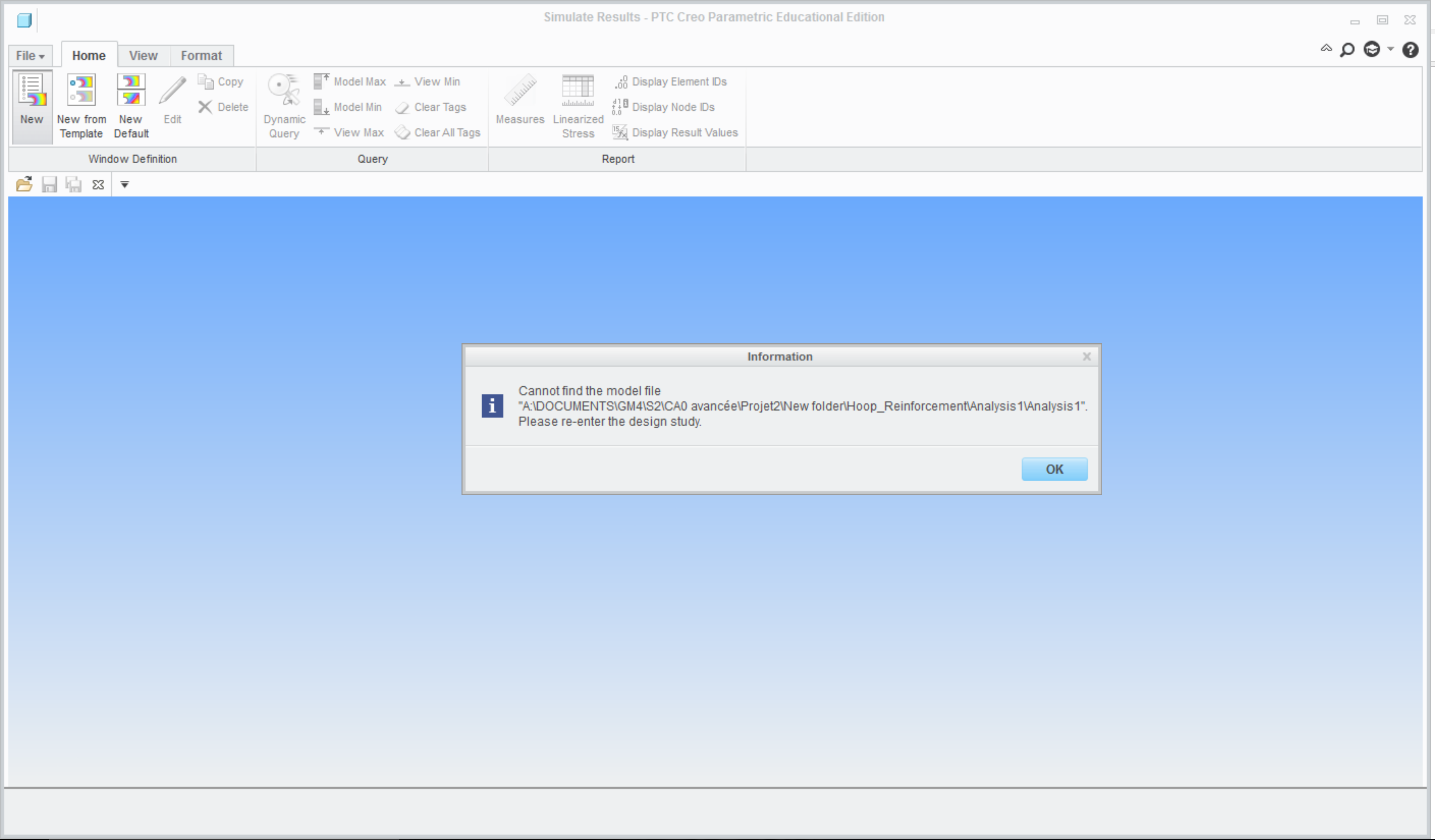

But then I open it and it says that :
My teacher tells me its because I have not enough space and the run is autodeleting itself...well I have more than 20 GB.
Sometimes it works, sometimes it doesn't...the sure bit is it tends to fail more and more.
The analysis is there anyway. And if it weren't there, why does this happen ?
Have you already encountered such problem, I yes could you help ?

The same problem occurs at our company either. This is such an disappointing issue, because the analysis report shows a completed run without any errors and all files seem to be available (compared to other previous analyses).
Is there anyone who has a suggestion?
August 25, 2017
Hi again.
Shortly after posting my previous reply I solved our problem.
I can't see how your destination folder is named, but we had a german "ö" in our folder name. So we renamed it to an "oe" and that's it. Seems to be a problem with unicode. Should not be an issue in 2017. At least I expect an appropriate warning message.
April 18, 2019
Same situtation, when my folder's name include Chinese character.
it solved by changing folder name to full enginelish .
