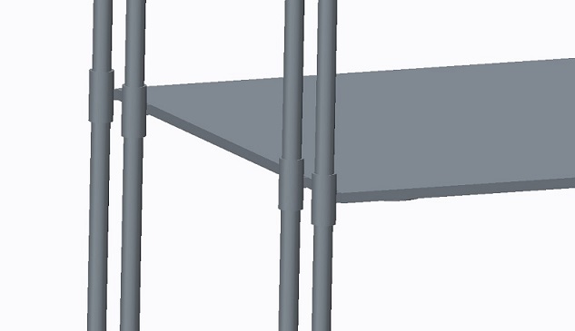

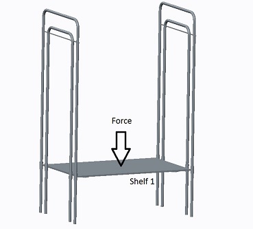

I have a shelf mounted on 8 separate columns. A force is applied to the shelf in the direction of the arrow. Is it possible to find out if the shelf will slide down depending on the size of the force?
July 27, 2015
Hello Johan,
I think that this will not be easy due to the phenomenon of arc boutement.
Kind regards.
Denis
Arc-boutement — Wikipédia
jhabbe1-VisitorAuthor
July 27, 2015
If we ignoring the arc boutement in this construction. Is it possible to do this type of simulation in Creo 2.0?
