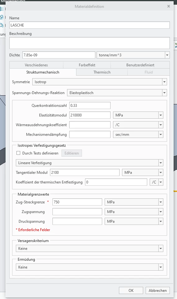

You are going to need to provide more information. Likely causes:
  1. Your input is using the wrong units and is just over whelming the results regardless of what material you choose (what is your load?)
  2. Your material files do not have accurate material properties (can you share a screenshot?)

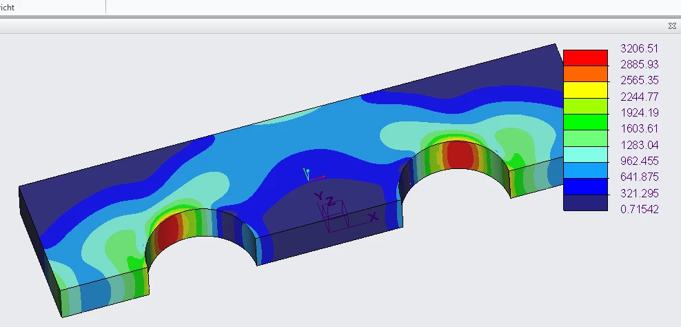

I try to load the Plate to breaking  strength (15KN) but I always get a very high stress at one point (see attachment)

Material values look ok

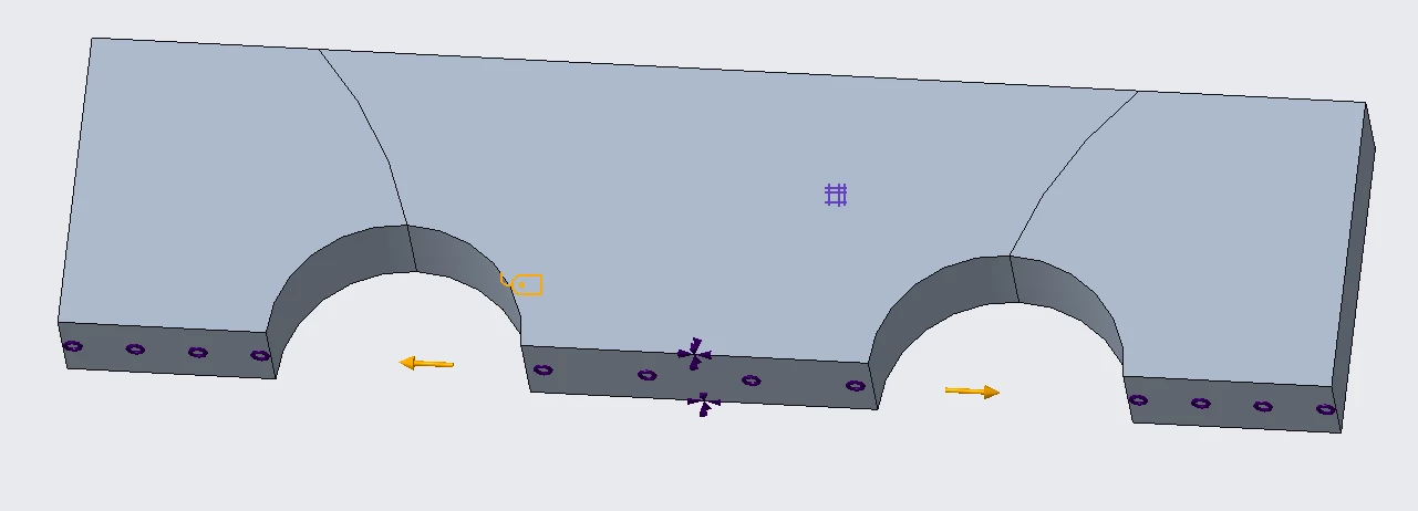

It looks like you have two different loads being applied its unclear how they are being applied. It also appears that you have the 3 front surfaces constrained in all degrees of freedom. Is this part welded and then there is a load being applied on the half spheres? If not how is the load being applied? I question whether or not all 3 of those surfaces are really constrained in all degrees of freedom in your real application. Stresses can be very high when you over constrain the geometry so it has no where to go. In real life though this is likely not the case. It will twist and or translate to relieve the stress.
When you change the material is the stress always 3206.51 or does the number change even a little bit?

The stress pattern looks good. Have you done a rough hand calculation to get a ballpark figure of what your stress results should be?
Apr 26, 2023 12:18 PM UTC
For a single material, single component the stress is not a function of material. Try changing materials dramatically and look at the deflection instead.
Apr 26, 2023 12:40 PM UTC
Indeed! Please recall that "stress = force / area" - material properties are not part of this 1st principal relation. Always review displacement magnitudes and their exaggerated animation before making conclusions...and always review other stresses besides von Mises (like max & min principal)...and check your strains when applying polymers!
