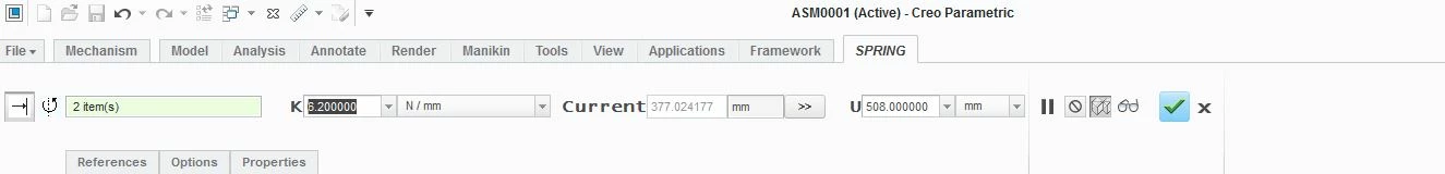

Hi All,
I am trying to run a mechanism analysis where a body of approx  20kg  is held by a 2 springs and is free to fall for a 1m dueto gravity. So when the analysis is over the body compresses the spring and bounces back.
In Creo i can only define spring unloaded length , current lenght , and stiffness coef. I want to see after running the simulation would the spring go solid or not.

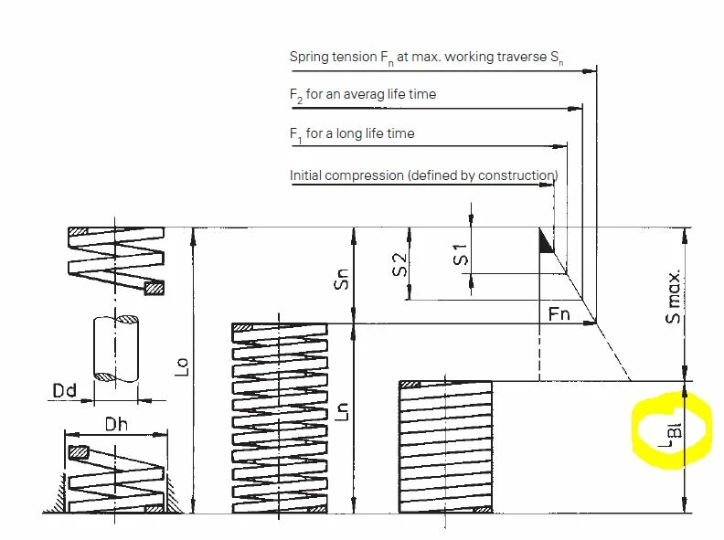

Is there an option to define a solid length ?
Mantas
September 18, 2017
You know how much energy will be stored and the approximate spring rate. It's an easy calc to make even without Creo.
