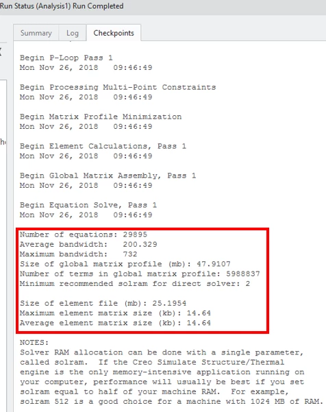

The auto-generated statement you've shared is a very old one that should be replaced. I believe this description is almost word-for-word the recommendation RASNA used when the tool was RASNA Mechanica Structure (late 80's to mid 90's). If I remember correctly, "solram" was an environmental variable you would set to force the amount of machine RAM to use. When was the last time anybody used a computer with 1 GB of RAM to run FEA? In fact, when was the last time a decent computer came with 1 GB RAM? There are much better recommendations/guidelines found in the help for Simulate, under "Memory Usage - Different Scenarios".  If you review the "Checkpoints" log file following a run, you can find useful information (and the boilerplate statement shared originally by "fstopelli"). In the following text, you'll see some information (red box) that would help provide estimates for what you should use - 2 MB is the minimum recommended for this problem, but 50 MB would be enough to hold the entire global matrix:

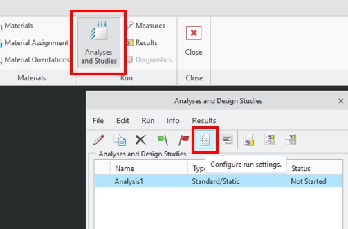

The details to set the RAM are found through these icon picks:

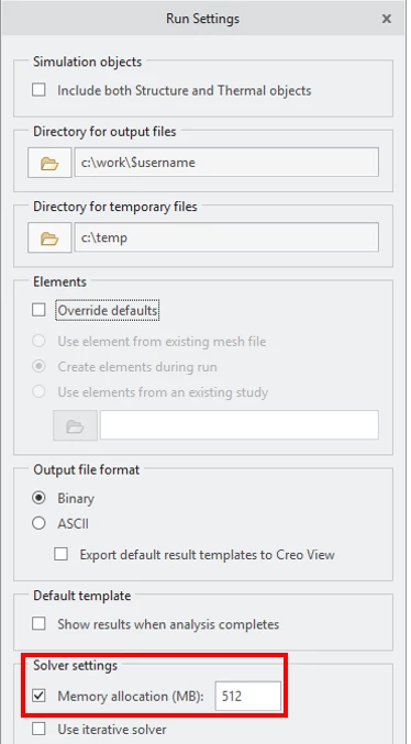

The "Run Settings" dialog will be displayed where you may enter a value for solver RAM:
