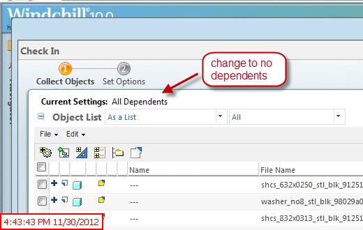

You are checking in new objects, therefore you do not have the option to
check in with No Dependents.
WC must have at least one iteration of a file in order for you to
exclude it from your check-in.
~Dan
~Dan
