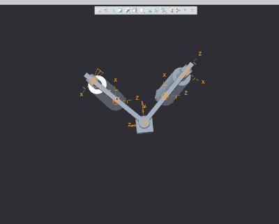

Spherically Released Cylinders to Move a Gimbel
Anyone have an idea on how to set motion up for Sphericaly released cylinders.
I keep getting an error due to the rotation to the cylinder.
I am also getting an error on my gimbal. I want it locked out so it can't spin. Want the range of motion locked to 12 Degrees.
I have tried having Sub-Assemblies (Cylinders and Gimbal)  and all components in one file. I just can't get this one to work.
Gif of motion I want. (Forgive me for the poor dragging)
I actually want to move the cylinders thru the sweep ranges and make a motion sweep of the area.
Any Help is much appreciated.
Gif and Dummy Files attached.
October 4, 2019
I recommend changing your 4 gimbals to match your center X connection.
Each gimbal would then have two pin joints and a dummy part for the X.
To make your motion, record the cylinder extensions at each of the points you want to reach then use a tabulated servo motor to control each cylinder.
