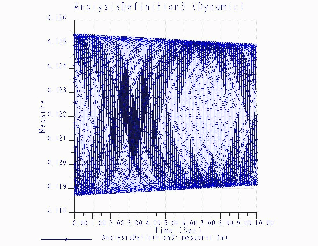

I created a simple macpherson strut with a spring but no damper and applied gravity only.
the simulation ran fine but then I found that the system is damped (see attached graph).
Why?
I applied no damping and no friction, so why is it slowing down?
Thanks!

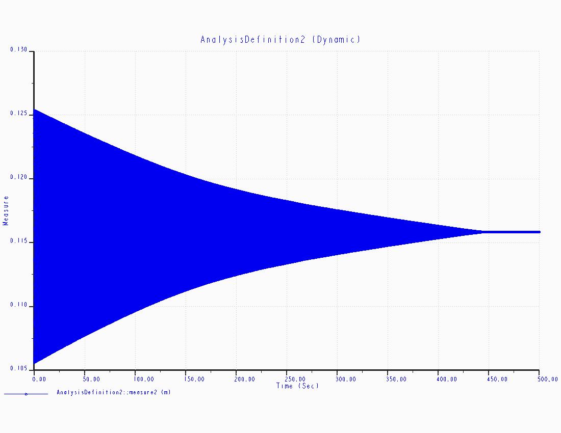

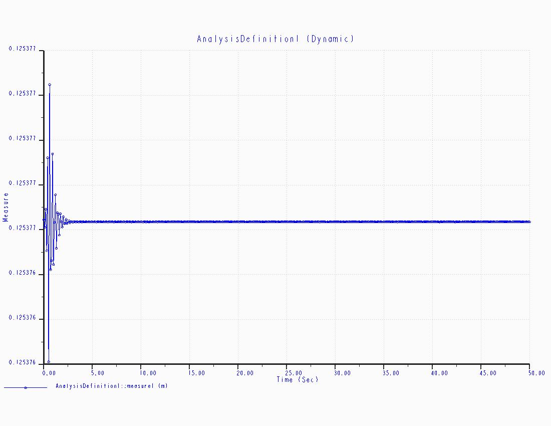

ok, so I ran the simulation again.
first time for 50 sec with gravity turned off
Second time with gravity on for 500 sec
In both cases the system eventually relaxes
My question remains, why?
May 22, 2014
OK, that's unusual. With gravity and friction off, a simple spinrg-mass system should oscilate indefinitely. Can you share your model?

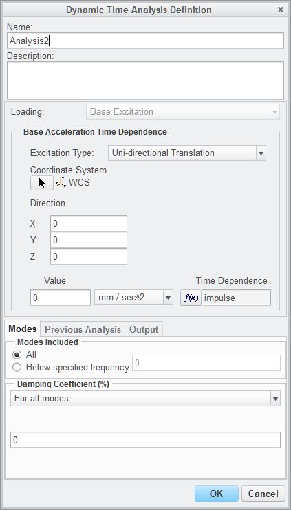

Please check whether your analysis happens to have structural damping selected.
Then switch this off, or set to 0%

Where would I make that selection?
I couldn't find the option in the menues
Is it a selection that i make for each part or the whole assembly?
May 27, 2014
You do that in the time response analysis definition, in the bottom of the form: damping coefficient
