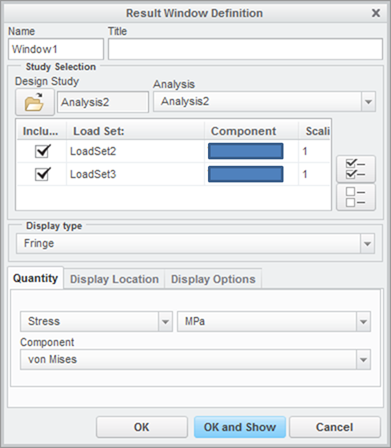

LINEAR - SUMMED
As you realise, de-selecting 'Nonlinear/use load histories' makes the model linear. It instructs the Simulate to ignore the contacts; which it does. Then you have to bond bits to stop the model falling apart.
De-selecting 'Nonlinear/use load histories' makes the 'sum load sets' check box available (and the time function disappear). This 'sum load sets' check box effectively puts all the loads into 1 loadset so they act simultaneously. It behaves the same as you putting all the loads from all of these loadsets into a single loadset yourself.
You cannot have more than 1 gravity load in a loadset (or simultaneously applied from many loadsets) and so Simulate complains.
LINEAR - NOT SUMMED
De-selecting 'Nonlinear/use load histories' and NOT using  the 'sum load sets' check box means that Simulate will run the model as many times as you have loadsets. Look at the summary file and there will be as many lists of measures as there are loadsets. Each list of measures associated with a loadcase. There is 1 result file on the disk for each loadset.
Because the model is run sequentially, once for each loadset there is only ever 1 gravity load at any one time and Simulate is quite happy.
If you then post process these results you are presented with an additional check box that permits you to scale and sum the results for each loadset
This is linear superposition and as Steven says (and what you have discovered) you cannot do this with non-linear results. So as you conclude, you have to run each loadcase as a separate, non-linear study.

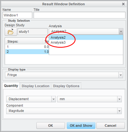

Steven's suggestion of using a design study will speed things up as remeshing between cases may be avoided and you don't have to hang around to press the start button for the next analysis. (batch files may also be useful for this).
Look at the design study summary file and there is a concatenation of analysis logs. Remember that the results of each analysis are in their own sub-directory in the design study but otherwise completely unrelated and cannot be added in the post processor. When you review these design study results then there is a pull down menu for you to select the analysis (loadcase) of interest.
