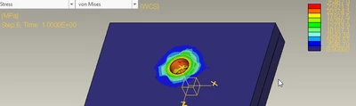

   I've recently dabbled into CREO simulate. I'm having trouble working with fasteners and understanding why such low fastener preloads produce insanely high stress values. I'm using CREO 7.0
When I apply only 10N of preload to my fastener (1/2"), I get thousands of MPa on the metal plates. I have no external loads applied. 25000MPa. WHY?

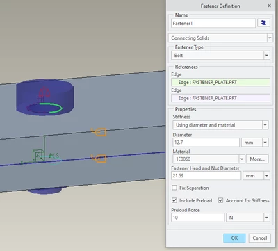

Here's a look at my fastener.

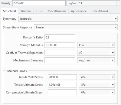

And here's my material.

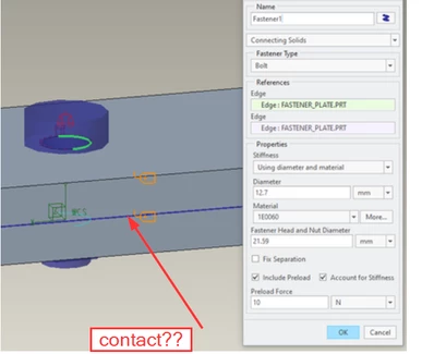

Contact analysis?
