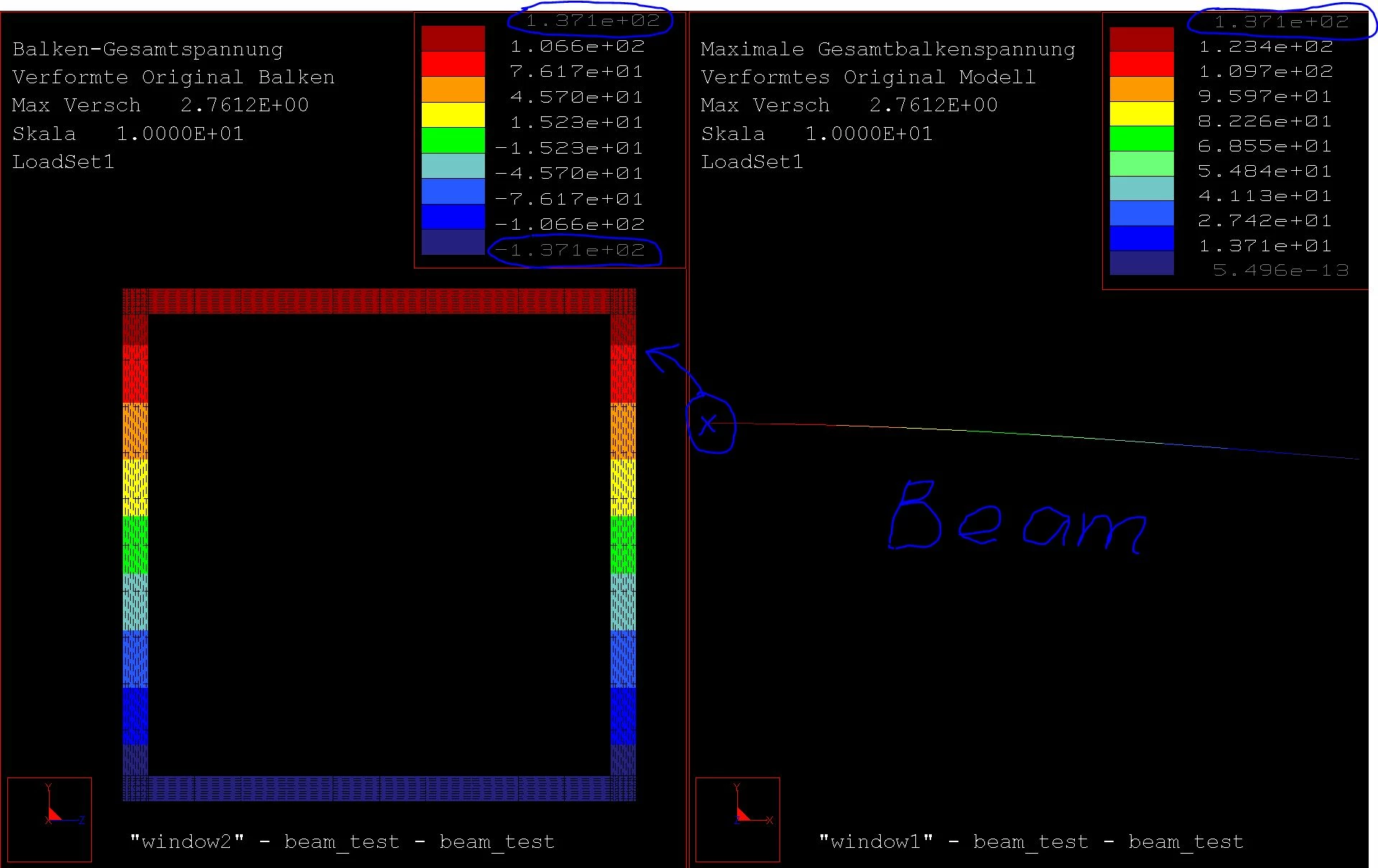

is it possible to display stresses in creo simulate 4 or 5 over the cross-section of a beam analysis (as previously possible in "old" MECHANICA)?
unfortunately i don't have creo simulate 4 and 5
regards

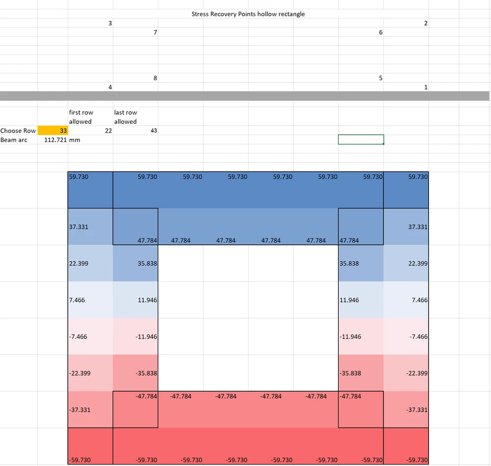

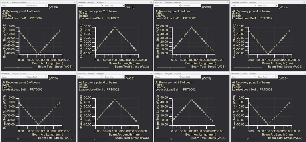

Best answer by SweetPeasHub
No, Creo 5 has no cross section view.
Instead stress recovery points vs. the length of the beam.
Attached example possible workaround using excel by exporting 1.xls, 2.xls etc. then use "Section Plot.xls"
(open all 1.xls, 2.xls etc. before open "Section Plot.xls")
