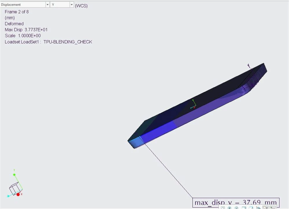

I have done simple stress simulation to check the max displacement of parts' blend amount from Y axis
It is shown the max_disp Y value is 37.69mm, but I see from the animate picture, the movement of parts is less than 3 mm. I had set the DISPLAY OPTION Scaling to 1
What does it mean of Max Displacement_Y value??

The number in the upper left is 3.7e1.  It is the same 37 mm displacement as your annotation.  Are you referring to some other value or result that isn't shown?
