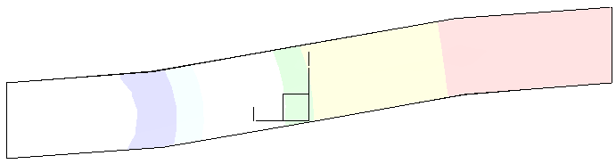

You can do your own testing, but I just ran a study on a 1x1x.25 thick part. I fixed one end and I added an applied displacement (.25) to the other end.
Looking at a side view it appeared that 25% scaling made for 100% real life scaling (ie I expected that the displaced bottom edge lined up with the fixed top edge on the opposite surface. I then changed the applied displacement to .125. This time though when 25% scaling the displayed result was the same which isn't what I expected. at 25% scaling for a .125" displacement the displaced bottom edge lined up with the fixed top edge of the opposite surface as before. I would have expected it to be half my first result because the applied displacement was half.
That being said it appears that the scaling is based off of a bounding part size and not the magnitude of the displacement results. To further affirm this, I changed the thickness to .125 and sure enough now a scaling of 12.5% makes the bottom displaced surface line up with the top of the fixed edge surface. Picture below is for the last case of .125 thick with a scaling factor of 12.5%.

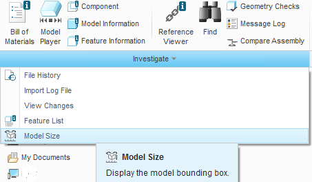

The scaling 10% is the default for a study without contact.
The largest displacement in the model is scaled to be 10% of the 'model size'.
All other displacements are scaled accordingly
