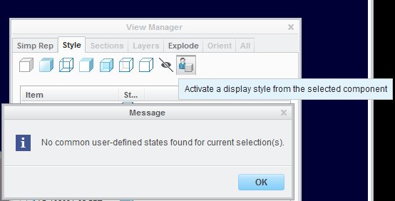

I would like to know how to use this function.  I cant find much instruction on it.  All the other selections for Style do their thing but when I select the "Activate Display Style" I get the error message about no common user-defined state found.  I'm not even sure this function will do anything I need but I'd like to figure out how to use it.

Hi Ken,
You can find some additional information in the Help Center under:
Creo Parametric > Assembly Design > Creo Parametric Assembly > Using Assembly > Managing Views > Assembly Display Style
You can take a look at the following documents:
About Display Style for an Assembly
To Create a Display Style
To Edit a Display Style
To Redefine a Display Style from the Model Tree
Display Styles for Components
I hope this helps.
