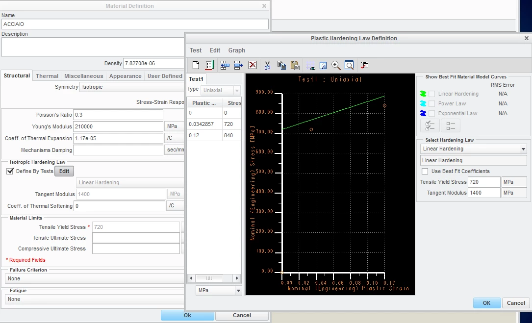

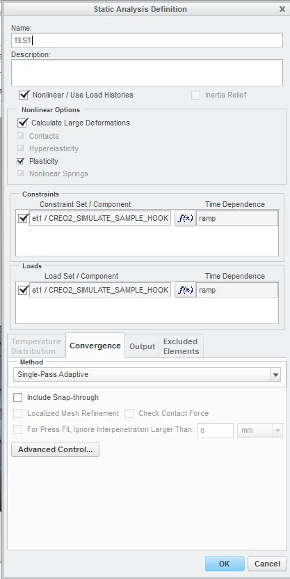

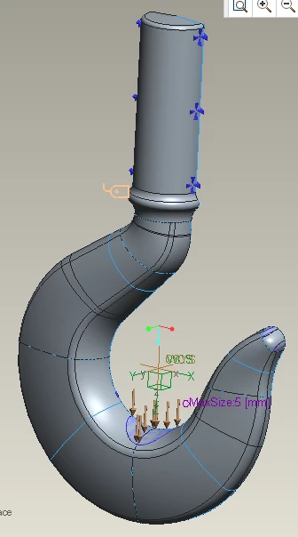

I'll be very grateful to you if somebody can help me to set-up and run this simulation.
We're talking about a hook and a static simulation of tensile test. Body is an half due to simmetry. Load is 4 tons (on an half). Shank hook is restrained. I want to check behavior of this hook when subjected to 16 ton (on a half). Experimental test show that there is large deformation, but load is hold and there is no crack. Attached pictures of setup and complete .prt file for simulation.
