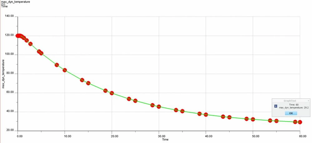

120° cooling down 4 Sek
November 27, 2018

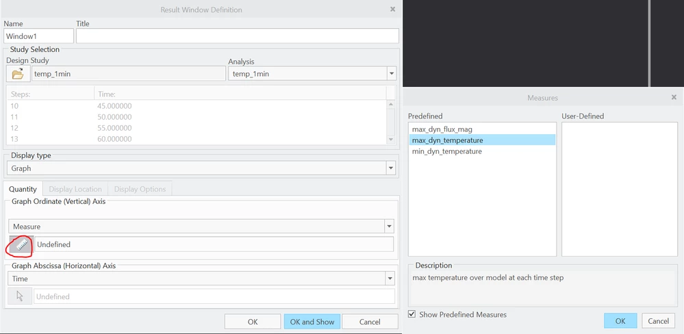

what does it mean "4 sek"?
Where I can see the time to cool down from 120° to 25°?
Thank you

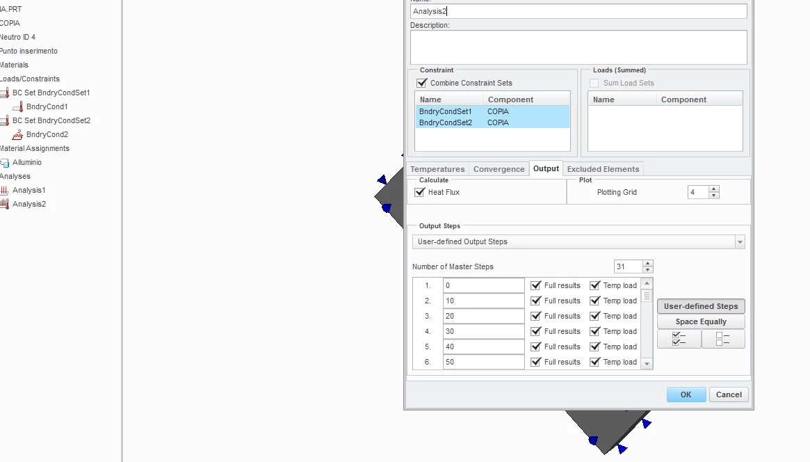

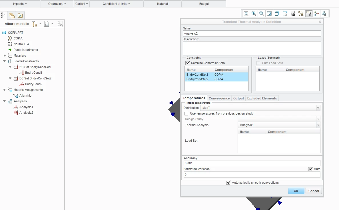

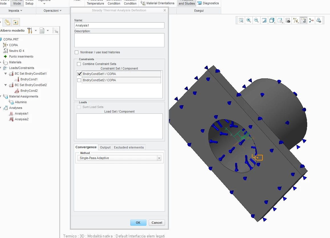

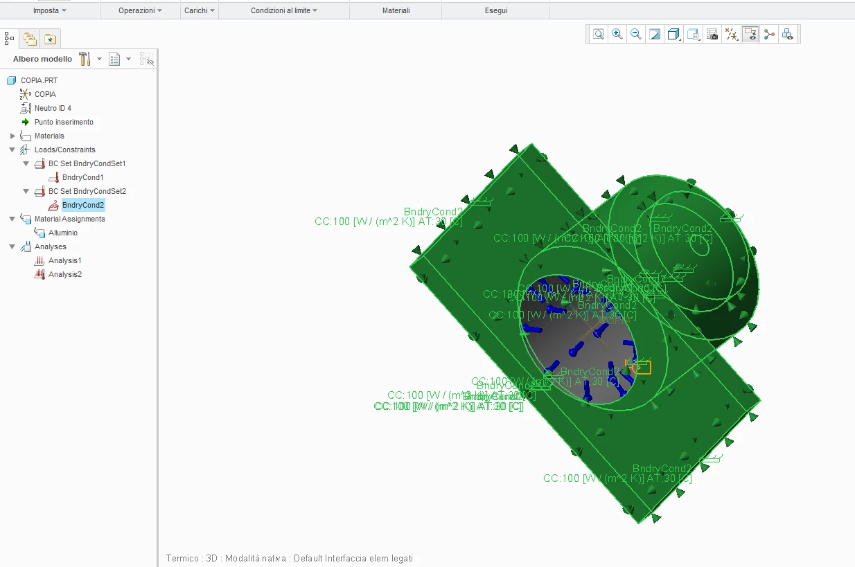

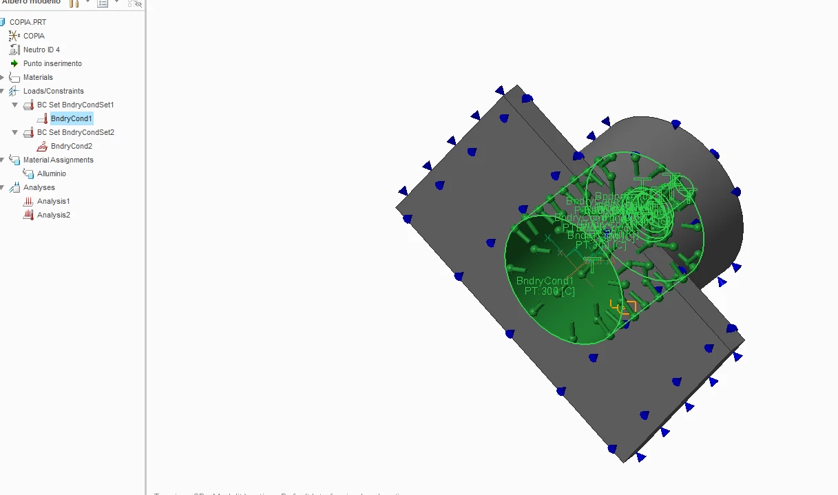

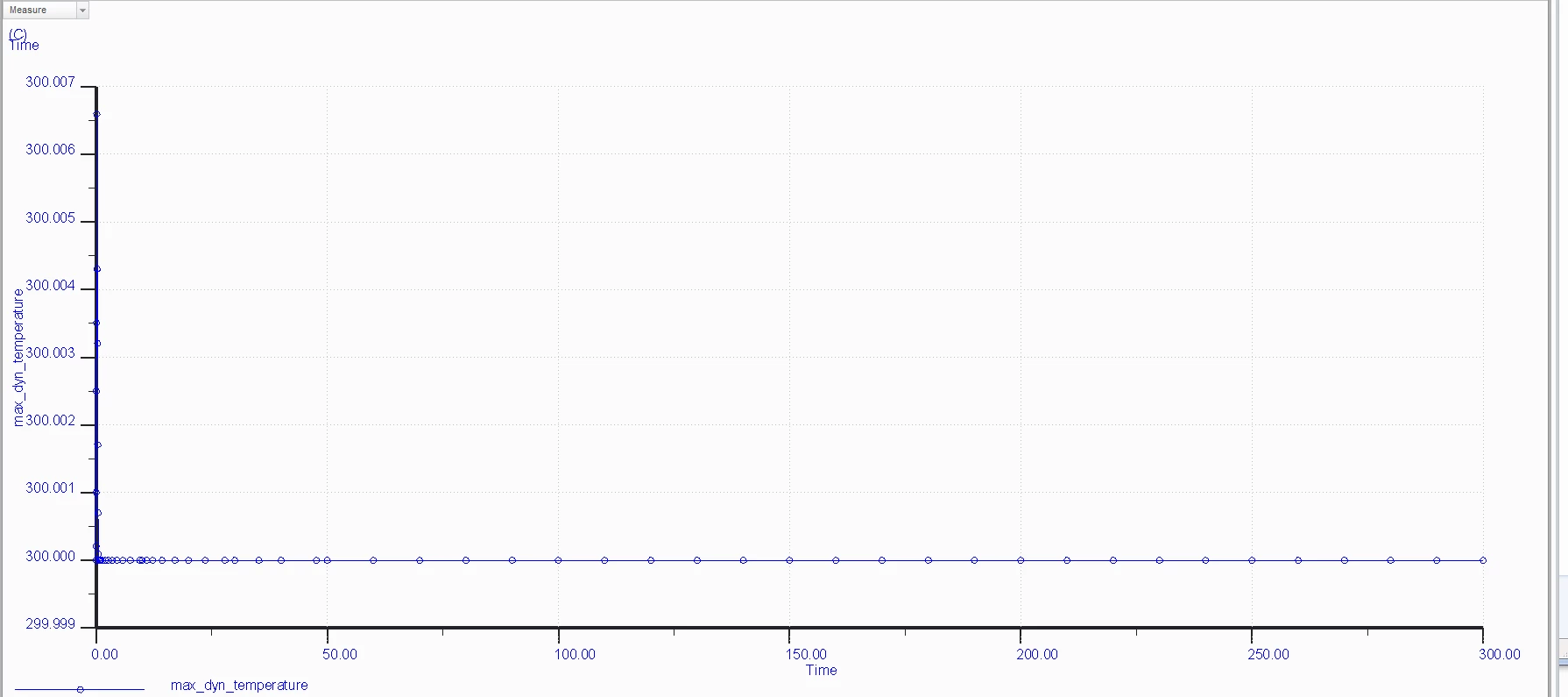

I tried to do analysis but there are problems...
skunks
November 30, 2018
loadset1->boundary condition1
loadset2->boundary condition2
December 1, 2018
Sorry, it's not clear....
