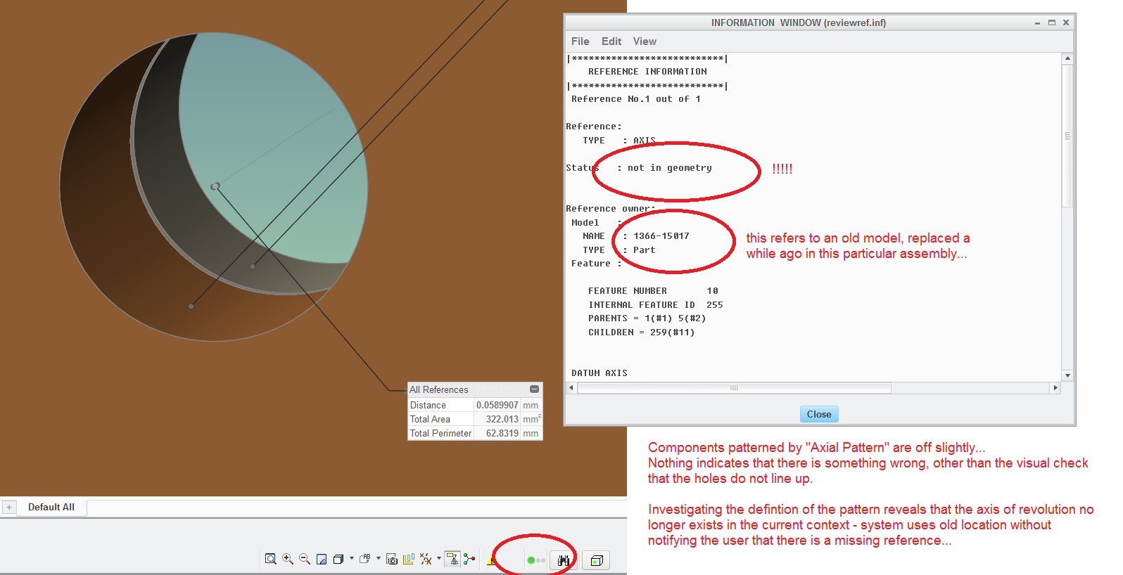

I stumbled on the reverse case - I have an assembly that shows a green light, yet the components in it are not located properly.  I am wondering if anyone else came across this issue.
Here was my situation (Creo 2.0, M210, btw).  I noticed that the patterned components in two of my assemblies were not lined up quite right; this was not a graphics artifact - as the measurement tool was reporting a small but significant misalignment.  The green light indicator was not showing anything wrong, and I didn't see any warnings in the message log.
So, after double-checking all the dimensions, I started to look at the definition of the pattern (axis-type).
In the first assembly, when I initiated the edit-definition of the pattern, the clue to the problem presented itself, as the selection box which contained the axis reference showed a yellow ball:
I re-selected the axis of revolution and regenerated and then all the components were lined up!
The troubling aspect is that there is a flagged problem with the reference in the feature definition, but the overall traffic light indicator isn't showing a yellow light.

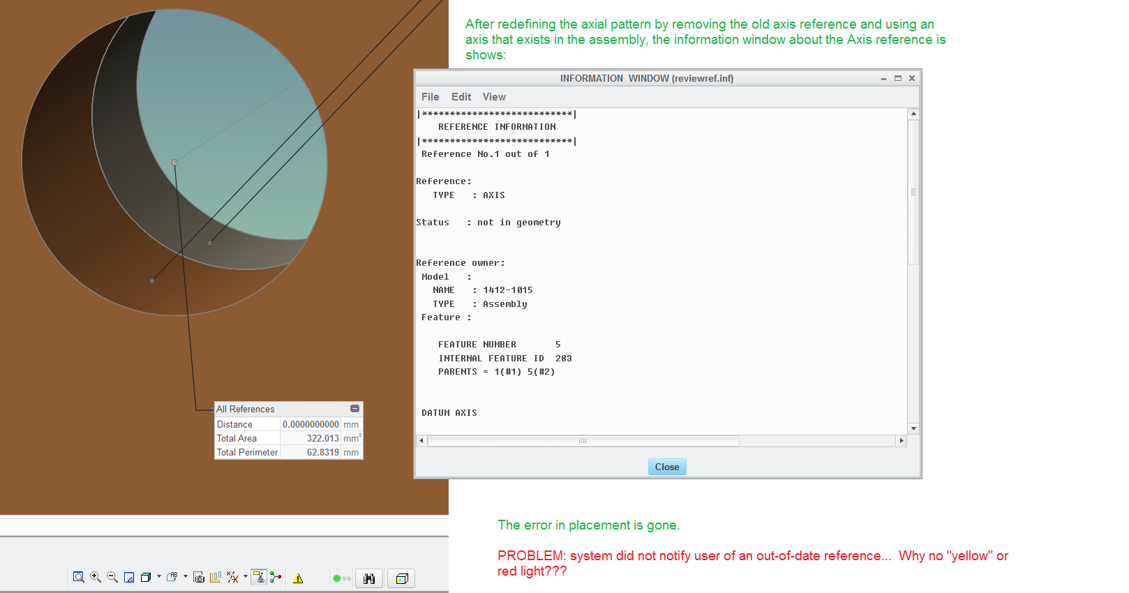

In the second assembly, the yellow ball indicator for the axis reference was not there, yet the components were misaligned.  Little bit of more digging (right-click on the "1 item(s)", select "Information") showed there is something amiss:
Once again, I selected the correct axis of revolution and after regeneration the assembly components were lined up:
So just a warning to you all - green light does not always mean it's a go
