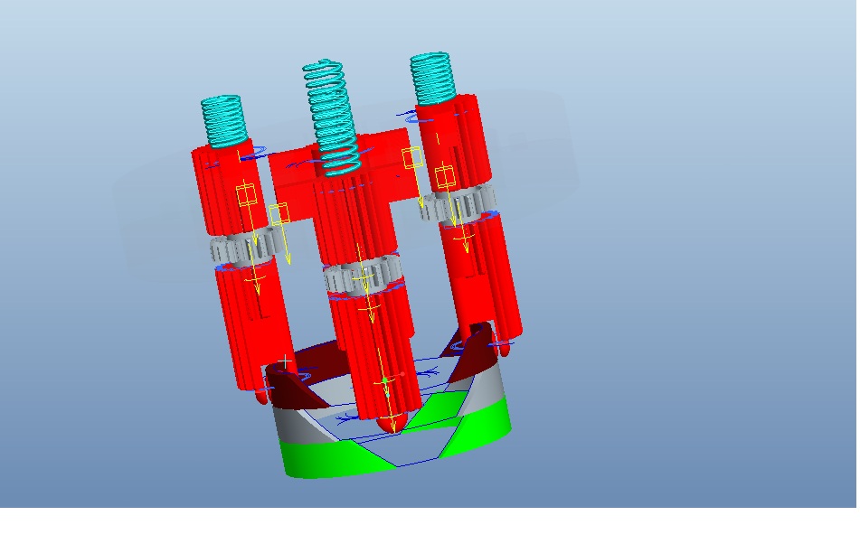

I have three trajectories & I have a cylinder that
slide up & down while the trajectories rotate
when the 1st one rotate it make the cyl doesdown
for 2mm then when the second rotate it make goes
down for another 2mm &the the third hassame senario
Ihave to mention that every one of the trajectories
has its shape to let the cylmove up or down
the problem I tried to use cam follower but the sys
refuse to identify the trajectory as a cam
I used a slot connection it works fine for one
trajectory but when I tried to add the second
trajectory nothing goes right
I added a pic that i hope it may explain the
problem
please help me as soon as possible
thanks alot

Verify that that movement is only in 2 directions.
As far as I know, 3 dimensional cams are still not supported by Pro/Mechanism. (Hopefully this has been fixed)
See if cam liftoff is enabled.
Hope this helps,
Don Anderson

Something like this?
http://communities.ptc.com/videos/2466
