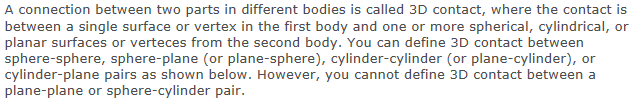

I would like to add contacts to my model.  There is a part that travels up an down a rod following cam paths attached by a spring.  I have a washer at the end of said rod, theoretically, keeping said "traveling part" from coming off the end of the rod.  When I attempt to use the 3D contact feature I am not able to select the two surfaces that I am interested in.

3D contact is picky about the type of surfaces used.  Take a look at this:
http://help.ptc.com/creo_hc/creo30_pma_hc/usascii/index.html#page/pma/simulate/3D_Contact/about_3d_contact.html

Hey Tom Thanks for the quick response!  So attempting to create a contact between to planar surfaces was my issue.  What if someone wanted to do this though, is there some sort of go around that your aware of?
August 24, 2016
You cheat.  Make a spherical surface that is tangent with the face of your planar surface and use that instead.
