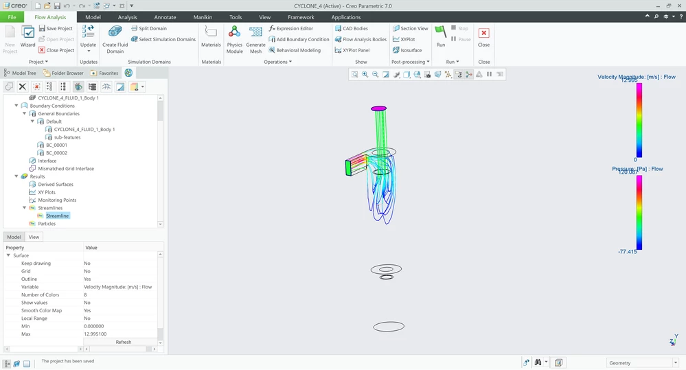

Hello all,
I am having some variability and issues with how Creo flow (7.0.8) behaves when trying to display outputs. This leads to three questions which would be great to understand. I guess the answers are in the config files, but can't seem to find the right parameters.
1. Transparency of a solid domain (showing temperature) used to also allow visibility to streamlines within the part. However, now for whatever reason it doesn't allow this. How can I get this ability back again?
2. Is there a way to change the outline colour from the very thick blue lines? They currently wipe out all detail with fine PCB components. Ideally 1 px and black.
3. At one point my model decided to show its own outlines, as 1px and grey. These weren't turned on as outlines, but were something to do with the 'flow analysis bodies' turned on. If I can get these to show then it will solve problem #2!
Many thanks

Yes there are some changes on the tree behavior. But you can achieve the same thing as before. The 2px blue outline only shown when you select some items on the tree. It is the highlight mode. If you don't select, all outline becomes 1px grey one. You can still select the streamlines and the domain and streamlines are shown together.
In creo9, we have better controls for sure. If it is possible, creo 9 upgrade is worth it. If you want to backport creo 9 to creo 7, it is still "possible" through addin mode. please contact Simerics.

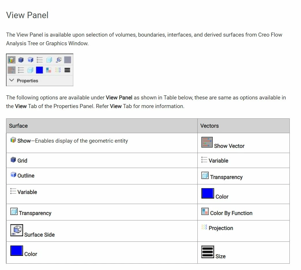

I have just been informed that the settings are available in a GUI in Creo 9. Perhaps anyone knows if they can be altered via any configuration in 7?
Creo Flow Analysis Interface (ptc.com)

Thanks, it sounds as if our uprgrade to Creo 10 will solve alot of the issues in general with 7! I am part of a large firm, so individual cases (such as backporting) is generally avoided wherever possible.
I found a workaround for the moment, by setting the selection colour to 90pc grey and selecting the items in the model tree I acheived a satisfactory outcome.
The transparency doesn't seem to have fixed, but that was a nice to have rather than being too important.
