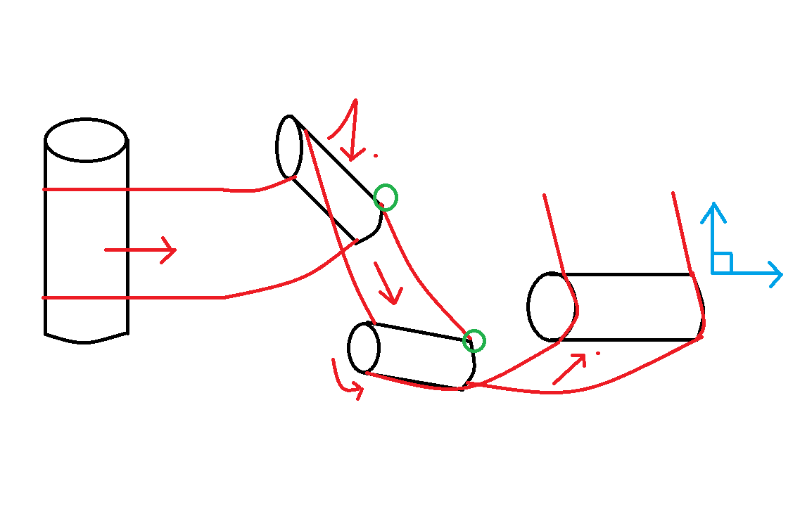

Hi!
I have a problem that I am working on. I need to get a plastic foil to twist 90 deg. from entering my system until leaving my system. For this I am intending to use some rollers to guide it from point A to B and getting the twist. I need to use this so that the twist doesnt affect the function.
Now, what I want to do is change the angles and positions of these rollers and basically see visually how the foil twists/moves according to these changes.
I've tried different methods without result.
I don't even know if this is possible to do in CREO but I ask to see if anyone has an idea/input to this.
BR/Stefan

November 25, 2015
Hi Martin,
Thanks for the reply.
I can not upload any images of the asm since it's company things, but I will just upload a quick paint image I made in order to explain.
So there are 4 rollers on the picture. The red lines indicate the plastic foil and the arrows the direction it goes. The two outer rollers are where the foil enters and leaves, as you can see I need a 90 deg. angle between them. If I would drag the foil right between these there would be a twist that would obstruct the function of the system. Therefore I want to place the two rollers in the middle (green circles) in angles and positions so that it will be a "smooth" transition in the angles for the foil.
The rollers are solid parts and the two with green circles can be placed and rotated in the model. So what I want to do is to change the position of the rollers with green circles and see how the foil moves according to these changes.
Right now I have set up a mechanism model where I have divided the long foil in small parts to make it flexible. I have placed pin joints in three directions and put weld in between each foil-part. The model gets quite heavy and doesn't really behave as I want, it also falls through the "ground" rollers if I don't weld it onto a coordinate point on the surface.
So basically I would like some ideas if this is possible to do in a better way or so.
I've only worked with Creo tools for 3 months since I graduated so I realise I know very far from everything in CREO. That's why I went here.
Hope this explained it better, have a nice day.

November 27, 2015
There's no function to simulate the stretching of the film if it really twists.
Other than that I'd look at modeling this with sheetmetal, starting with a long flat ribbon and then marking bend lines where the rollers will contact the film. It would be an iterative process to fit the ribbon to a desired roller path.
