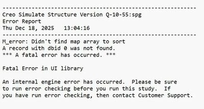

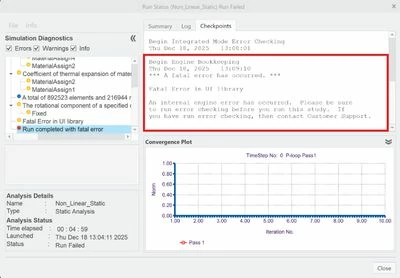

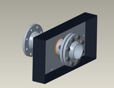

I am trying to perform a FEA Analysis for the below assembly with contacts. I am interested in a Non-Linear Static Analysis using the preload in the bolts, internal pressure in the pipe and axial load on the flange. I have defined custom time functions for these loads as per the needs but whenever I run the study, it fails throwing up a UI Library error. Can anyone guide me what needs done in such cases?
I have defined custom materials for the Gasket and the Rubber springs for its Density, Poissons ratio and its Youngs modulus and I hope that should be sufficient but still unsure if that might be the primary reason for UI Library Failure as the system does not recognize these custom materials?
Any Inputs are highly appreciated. Please see attached step file of the model for review.

What I think is that while first opening of a resaved FEM model it re-references all geometrical references of simplified elements and connection to new model references. And that is how it repairs broken simulation model. There is no way you will be able to easily repair UI library Error. As i've said this model will be borken forever.
My first attempts to repair the model by suppressing all elements of big assembly untill one part left in it but it still left with UI Library error.
Than I saved model as copy and everything was working normally. It is not in the enghine of a pre or post processor. It is liks between simulation model and simulation entities which for some reason starts to be broken for no reason.
