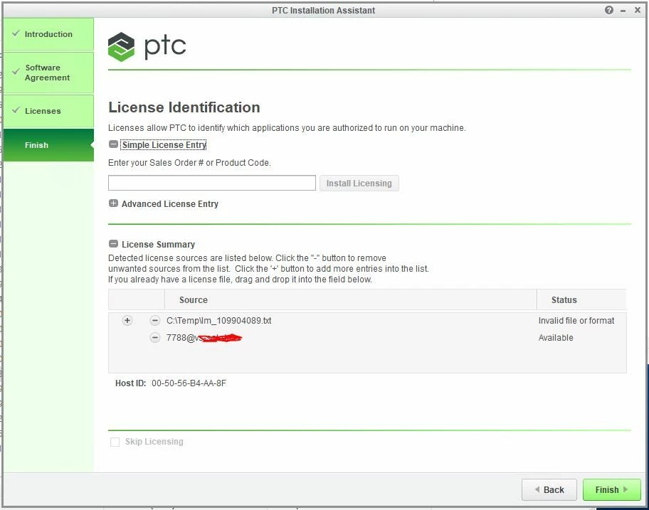

We are trying to install an updated node-locked license for Flow Analytics on a PC with a floating Parametric license.
When we add the new license in Reconfigure on the PC it displays 'Invalid File or Format'
Any suggestions?

please publish picture of reconfigure window. Also publish picture of the license file.

Jul 7, 2022 7:18 AM UTC
@AR_7917108 wrote:
1st picture
Host ID: 00-50-56-B4-AA-8F probably belongs to Virtual Machine.
I do not understand why you are installing Creo Parametric on Virtual Machine. Can you explain it ?

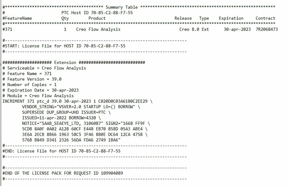

2nd picture
I hope it show contents of C:\Temp\lm_109904089.txt file. Is it true ?
This license file is pure nonsense.
Module 371 Creo Flow Analysis is not node-locked, it is floating.
Module 371 Creo Flow Analysis is Extension, this means it must be installed on the same Host ID as basic Creo license (floating -OR- node-locked).
Solution of the problem ... you have to move Creo Flow Analysis to the "Creo Parametric" license server.
