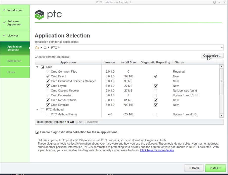

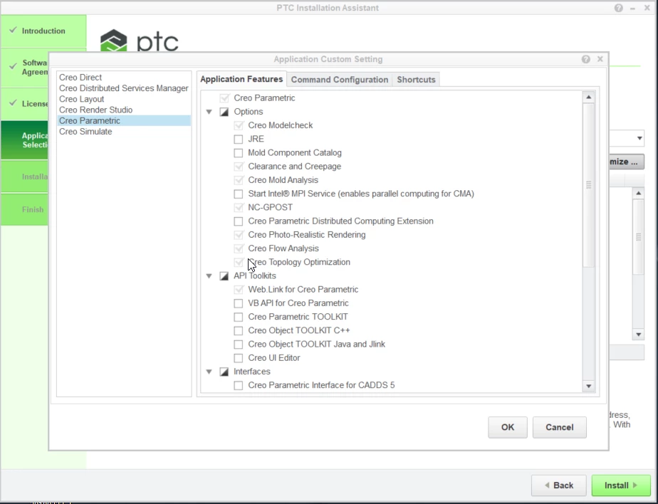

I am not able to select the topology optimization extension in PTC Creo parametric 5.0. Can someone help?
Best answer by ErikClacey
Reinstall Creo and select customization to select what to install -> check the topology optimization checkbox.
January 17, 2019
Hi Erik (or anyone else who might know) Is there a quick way I, as a humble user, can find out if my installation has T.O. enabled? It's an installation of Creo 4.0 M060 - was told that this feature was going to be back-ported into Creo 4.0 from M040. Is there a menu option, say, that I would or wouldn't see in the application itself? (I don't have user access to the installation)
Chris3
January 17, 2019
I am pretty sure Topology optimization is Creo 5 only. I tried out a demo of it and PTC said it only worked with Creo 5. I have Creo 4 M060 and it is not in Creo 4. In Creo 5 there is a a button for it under the applications menu but it won't run if you don't have a license and you haven't checked the check box to install it during the install.
