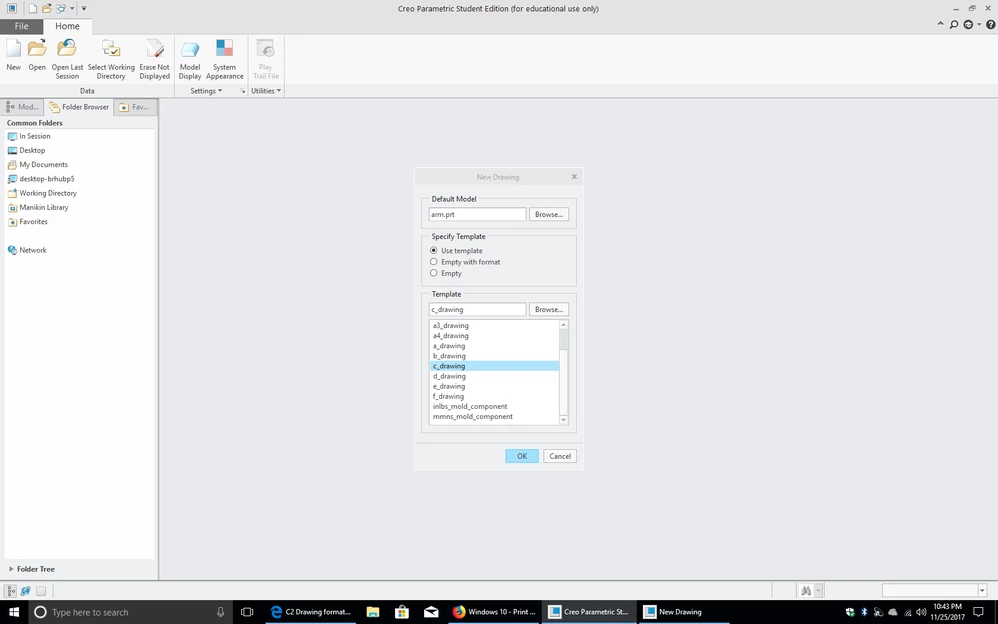

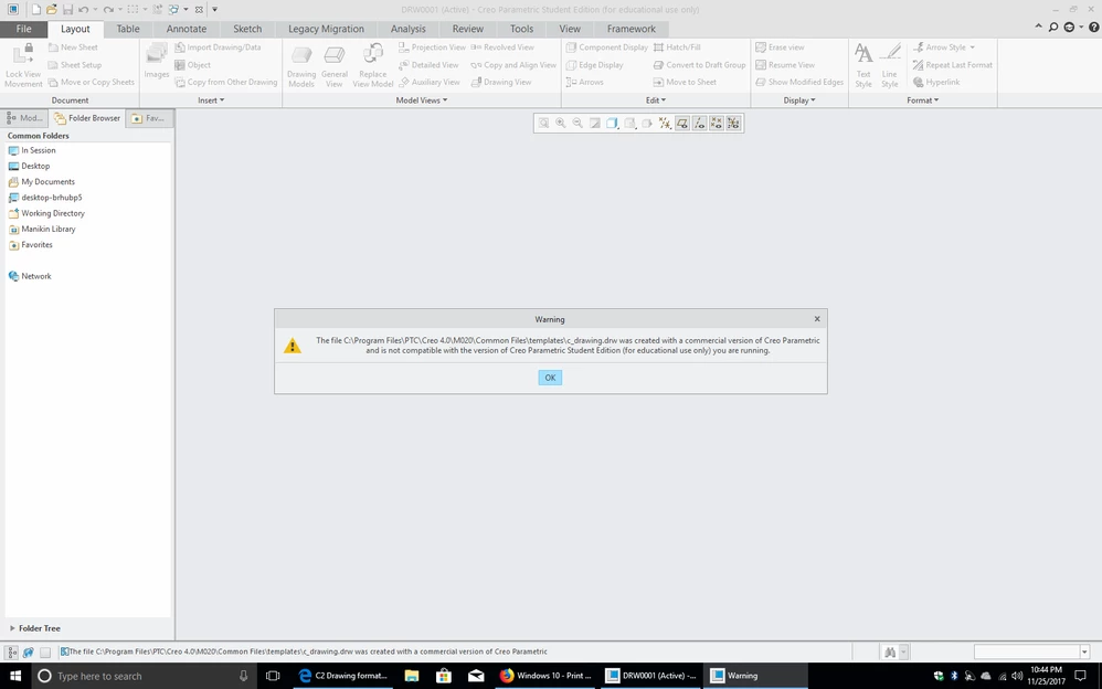

I am trying to get a lesson done for my Creo class which requires creating a drawing of a part. I have Creo 4.0 Student Edition for Windows 64-bit Pro. However, I get the following warning which says that the drawing templates that came with this student edition where created in the commercial edition and cannot be used!!! How can i get Student versions of these?

I think i found the solution. It seems that the choice of drawing templates that the popup gives is to the wrong set of files. Instead i browsed to another file folder that had a few of the same name files like c_drawing.drw. This one seems to work. The location of these other template files is:
C:\Program Files\PTC\Creo 4.0\M020\Common Files\creo_standards\templates\
Any other suggestions are welcome.
